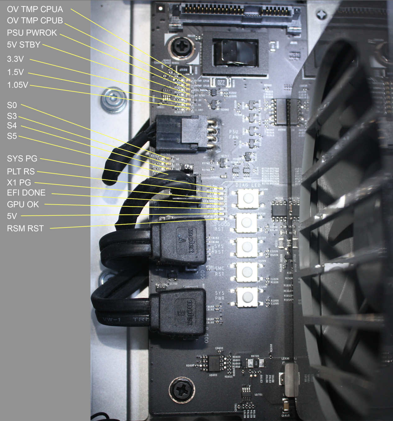

OP, have you done the diagnostic LED light test? There are diagnostic LED lights on the backplane that can tell you many things...
Look inside, to the left of the fan:

I did the light test a few weeks back and didn't see anything glowing up unfortunately. Since then, the Mac Pro issue has been put on the back burner. But now that you guys have kindly suggested a few more tips, I'll pick up on this again tomorrow.
