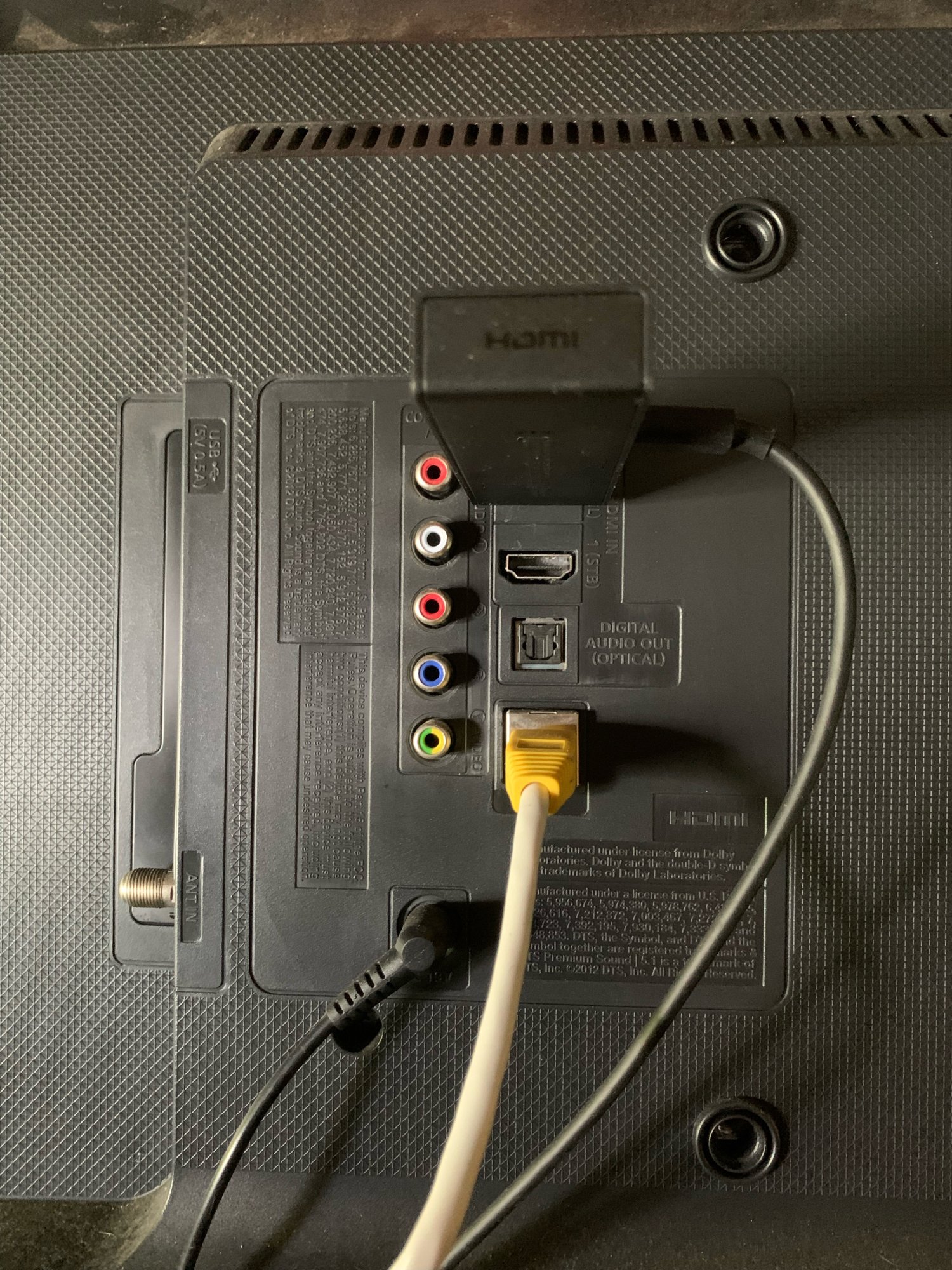

A follow-up question as I am considering traveling with the Mac Pro next week and I'd like to display the Mac Pro on a Samsung Smart TV. Would I effectively need a Thunderbolt to HDMI cable to achieve this or would a Thunderbolt to Digital Optical Out connect be better? I've attached a photo of the back of the Samsung TV that I'll be using as the display if it is possible.

Assuming this is a "4K" TV: You need either an active (important!) DisplayPort 1.2 to HDMI 2.0 adapter, which should™ allow "4K" at 60 Hz, or a simple HDMI cable since the trash can also has a HDMI 1.4 port. This will limit you to 30 Hz refresh at "4K" resolution though.
Thanks for the info. Unfortunately, it's a Samsung 27" from around 2016. Is it worth connecting to with that said or will it prove a bit 'annoying' if it is even capable of connecting to?
Then it’s probably a Full HD TV. You can still connect the trash can to it (a HDMI cable is sufficient). Text may look a bit “fuzzy” or “grainy” due to the low pixel density but only you can decide if it’s worth it.

+1 to anything @Amethyst1 said.
I doubt the TV is even 4K, let alone 4K @60Hz so just simply connect HDMI to HDMI (This includes video and sound).
You could tell us the exact model of the TV to be 100% certain.
With just a HDMI cable and your MacPro you can achieve FullHD @60 Hz or 4K @30 Hz.
If your TV is only FullHD (1920x1080 pixels) no other cable/adapter whatsoever can improve the quality/resolution.
If it is actually 4K AND 60 Hz capable, said active Displayport to HDMI 2.0 adapter makes sense to get a smoother experience. 30 Hz looks choppy even when just moving the mouse.
FYI: The optical out of the TV is to connect an external (sound) amplifier or speakers.
Reactions: goodwill
Thanks for the helpful info.
The TV is a Samsung Model: UN32J5205AF
The main thing I am looking to achieve by even connecting to the TV is to set up the Mac Pro as I just got it and to also use Photoshop on it for a few things.
As suspected: 1920x1080 pixels (Full HD) @ 60 Hz
So a simple HDMI cable is all you need.
edit: make sure that the sharpness for the input where you connect your MacPro is set to (almost) minimum, otherwise the macOS interface will probably look over-sharpened. Also check out the contrast setting on the TV, it might be too high as well (just select what looks good to you).
If you can enable a “PC“ mode for the HDMI input source, do so.
This is because normal TVs are tuned so that multimedia/video sources look good but a computer’s user interface requires different settings. Just tune it how it looks good to you.
