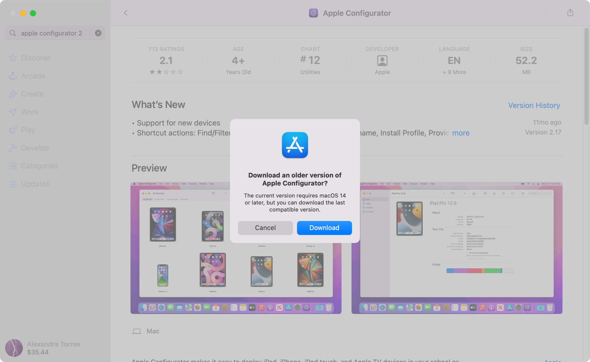

You couldn't install Apple Configurator on Monterey? I use that on my iMac Pro with Monterey 12.7.2.
As I documented in the thread tsialex was kind enough to reference.
Apple doesn't offer configurator for any OS version prior to macOS 14 now. If you already have it on Monterey, you're good, but you can't get it afresh.
The situation is far worse than I would have imagined, then.
That Apple stops selling the previous hardware models is one thing. But to cut off access to software just because one doesn't happen to be on the latest OS version is beyond the pale.
As macOS is updated with a new version every single year, and encourages everyone to do the upgrade.
Shouldn't the Apple Configurator be based on hardware support? And offer to download an older version based on the macOS version?

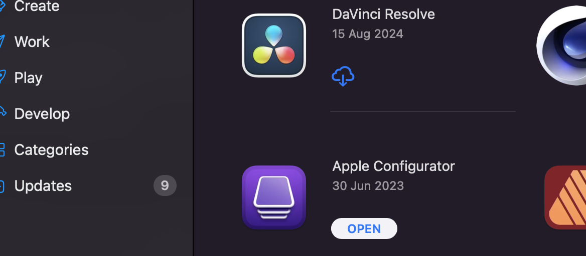

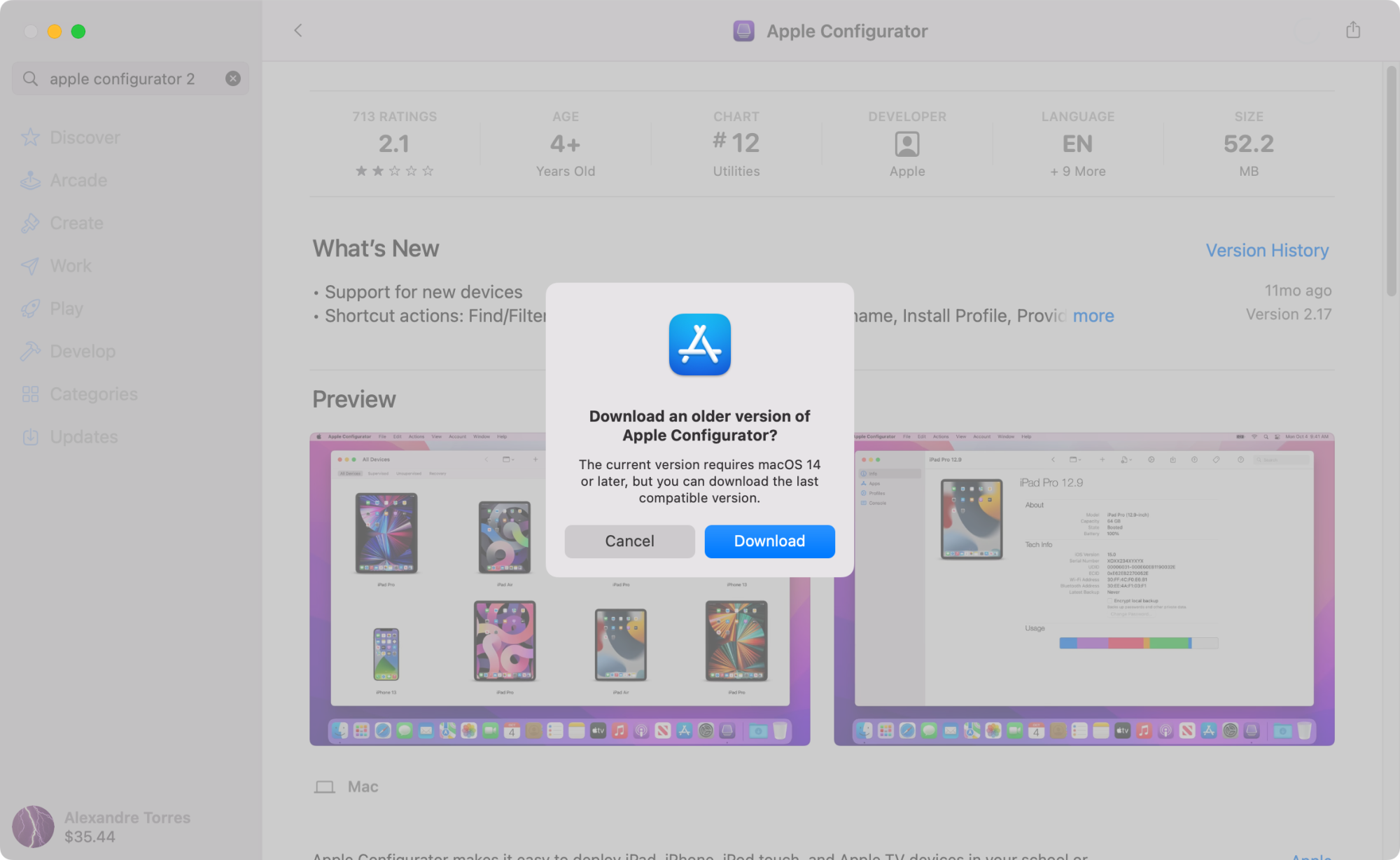

I just checked my version. I got mine June last year, Apple Configurator 2.16 with macOS Monterey installed.
The new version is Apple Configurator 2.17
Nope, just got it with a clean install of Monterey:
Maybe you are saying that you can't get if you never "purchased with the MAS" before, then you can get it for first time with Sonoma/Sequoia, go back to Monterey and download it.

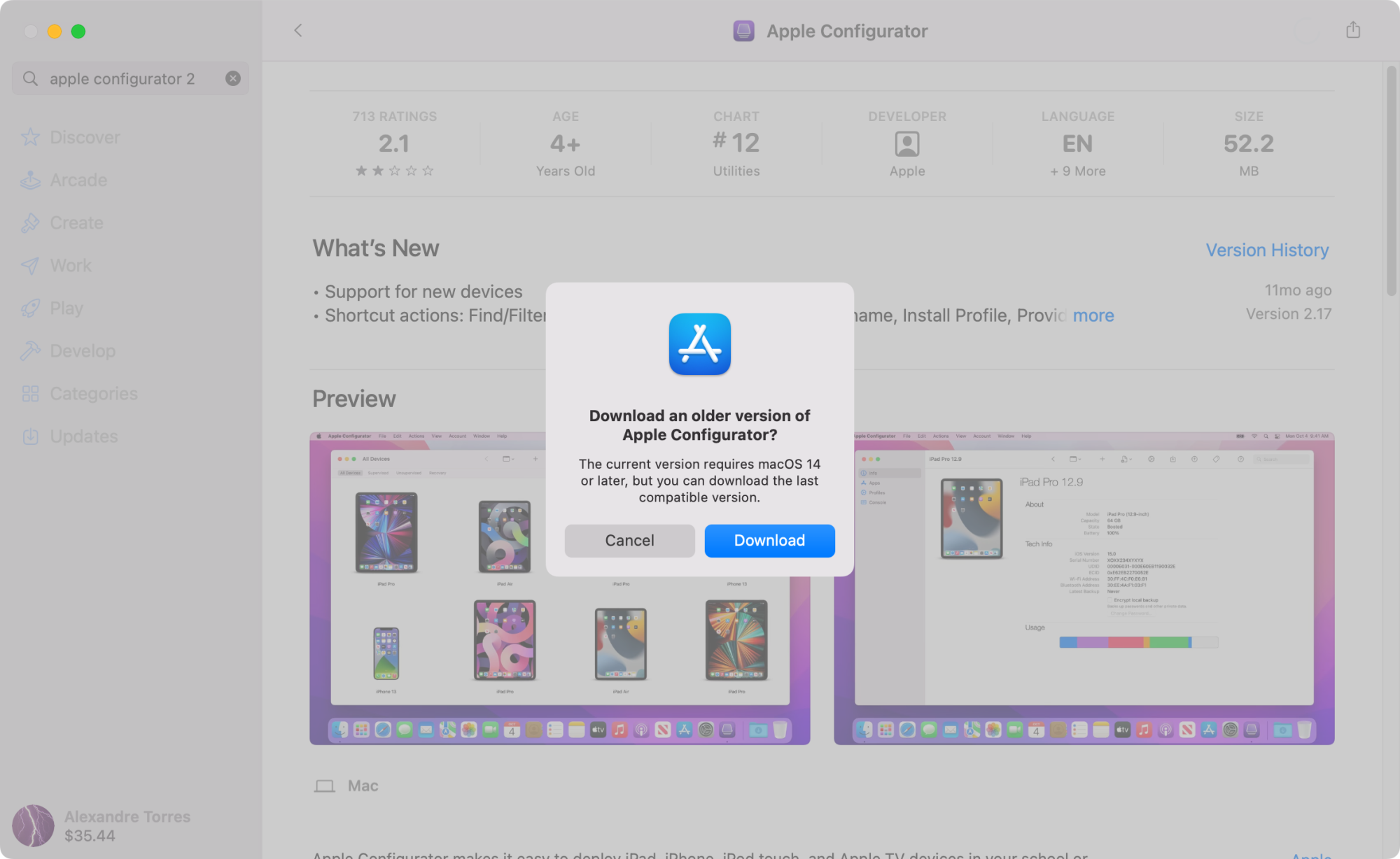

I'm on Ventura, I can't get a version of Configurator for any OS earlier than Sonoma.
I'd be curious what happens on a machine that tops out at Ventura or Monterey.

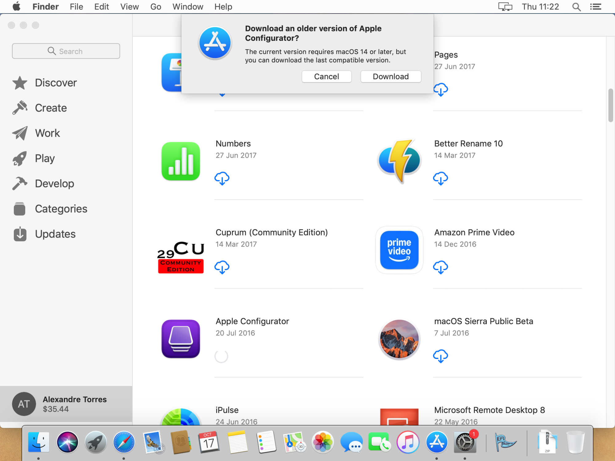

Possibly that's the subtlety, maybe if you have a machine that tops out on an older OS version you can still buy it and get the older version.
But they sure won't "sell" it to you if you're on an older OS version with hardware capable of running something newer.

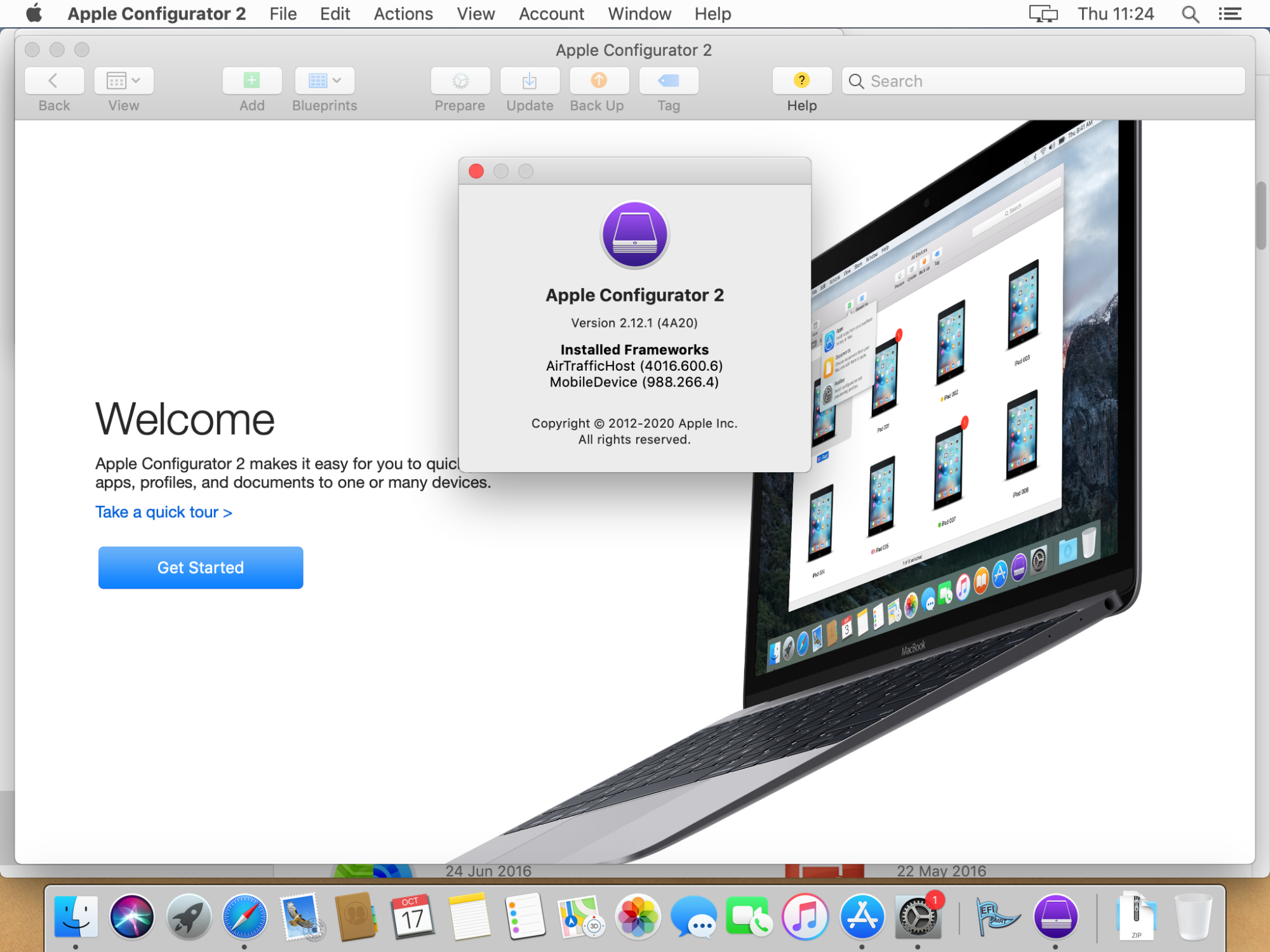

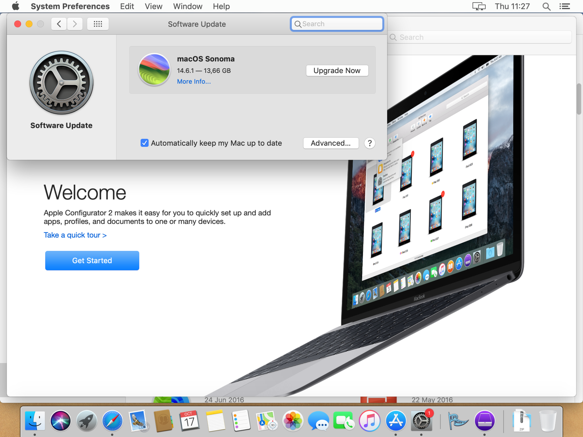

Just downloaded a previously purchased Apple Configurator 2 with a Mojave VM, no problem:
Same MAS rules as any other Apple software sold there, this VM can run Sequoia btw.
Just downloaded Apple Configurator 2 with a Mojave, no problem:

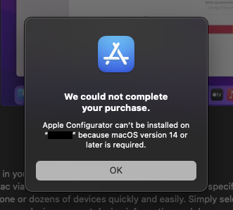

I'm trying to buy it for the first time on a High Sierra machine, and I get the same "macOS version 14 or later is required" refusal.
So that's the thing, if you want to get configurator now, and you haven't "bought" it previously, Apple won't sell it to you unless you're on Sonoma or later.
*edit* which gets back to my previous point - IF you need to do a DFU restore, you can't repurpose an old laptop to do it, if you haven't "bought" configurator at some time in the past.
