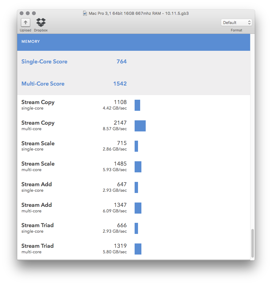

I ran Geekbench tests along the way and I had surprising results…
First up is the pre-upgrade test. So 16GB total memory made up of 8 x 2GB modules, and a mixture of 667mhz and 800mhz.
Next, we have my 800mhz modules only total of 20GB total, made up of 4 x 4GB and 2 x 2GB. Oddly, more RAM and purely 800mhz yielded a lower score.
So, after coming to the conclusion that 667mhz wasn't so bad after all I filled my last remaining slots with 2 x 2GB 667mhz sticks to take me up to 24GB running but running at 667mhz. More RAM but lower than 16GB running at 667mhz. Go figure.
Does anyone have the foggiest idea why this could be??

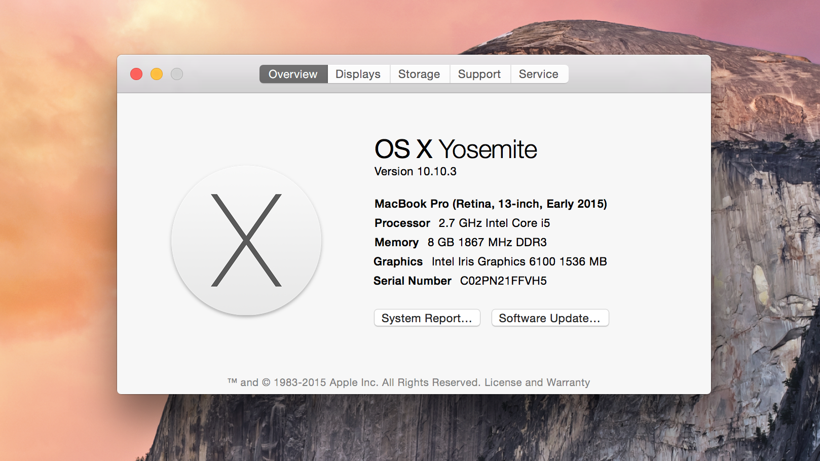

I believe you have to do an SMC or PRAM reset to update the ram capacity and speed. Many people have complained about changing the RAM but the speed was stuck.
Did you do the resets and then verify the actual speed and capacity the RAM was running at? If not, this may explain the results. Speed and capacity can be seen in "About this Mac":
