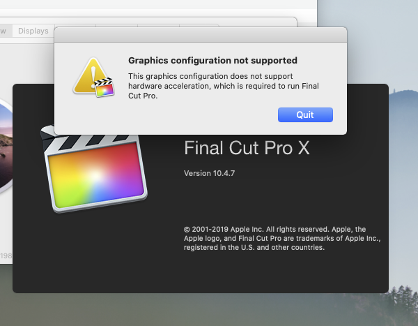

Hi. I've upgraded a Mac Pro 3,1 to run Catalina (via dosdude1 method with video patch), it works but the graphics are very sticky. So I swapped out the graphics card (ATI HD4870 512mb) for a GTX680 2GB and thought this would let me run FCPX but no, it's made not much difference.
Am I wasting my time, is it impossible for me to get this machine to run the latest FCPX or has anyone else managed this? I want to use it as an extra machine to render proxies, exports, etc overnight but the latest FCPX needs to have Metal to run.

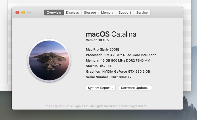

Also your final screenshot shows that you used the “legacy video patch” which breaks support for cards that do support metal. Which is why changing to the GTX 680 only helped a little. amd Polaris cards or newer are what macOS wants.
I thought that last screenshot looked weird.
To remove the legacy video patch, reinstall Catalina over the partition? It won't remove your apps, docs, and settings.

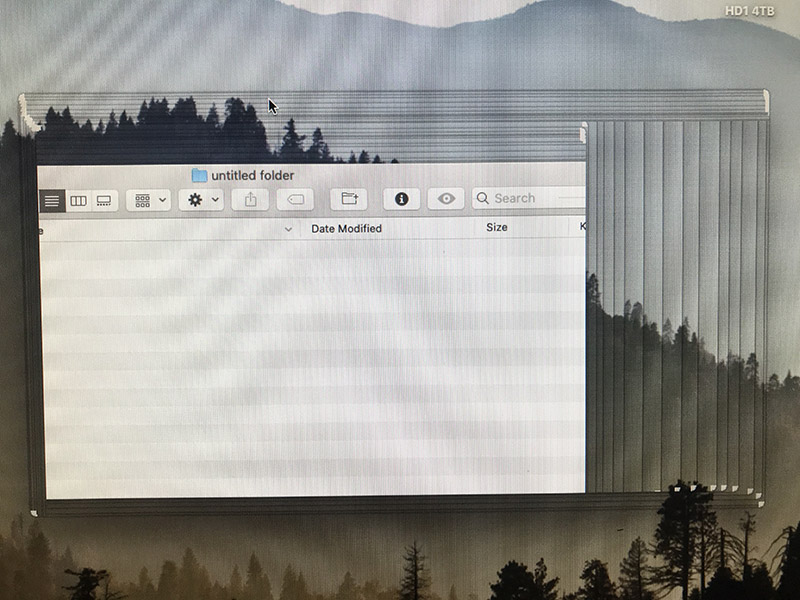

Yes, the last screenshot shows how when I drag a window it 'ghosts', like the graphics are slow & sticky. I've ordered a AMD Radeon RX580 8GB to try. So to confirm, regarding the legacy video patch - when I get it I should try it and if it doesn't work re-install Catalina? Or do I need to re-install before trying the card?
GTX 680 should not have those artifacts after you reinstall. You probably need to reinstall for RX580 anyway. Then you can try RX580.

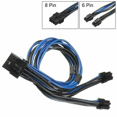

Hi, I'm trying to upgrade my 3,1 to run FCPX too. How are you powering the RX580? I read additional power is recommended.
Hi. I think I bought a different cable to connect it to the Mac:
I'm not 100% sure so please do some more research - i'm away from the Mac for a few weeks but when I get back I can check for you.
Ok, it looks like you just used proper cables. I also have a GTX 680 and might upgrade to the AMD RX 580. Don't they use the same cable?
