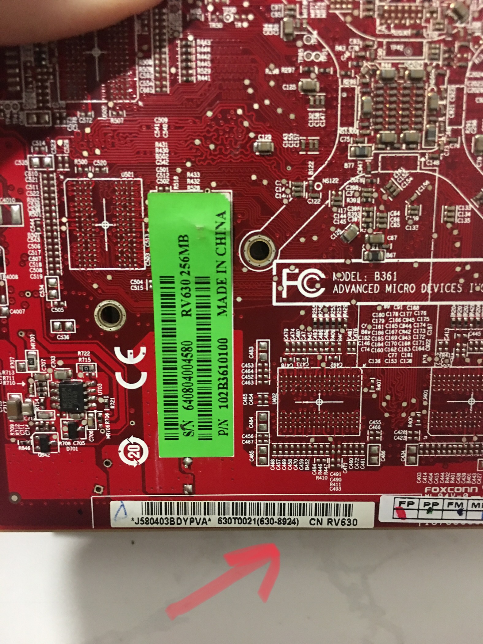

- Oh, and this is embarrassing, but not sure what GPU I have, but I believe it’s an original spec if that means anything (how does one tell just by looking at it?!)
Every original Apple GPU has a part number on it.
Apple HD2600XT, the 2008 original GPU, is 630-8924.
[doublepost=1535267027][/doublepost]Btw, it’s a 2008 Mac Pro (3,1) or a 2009 (4,1) one?
