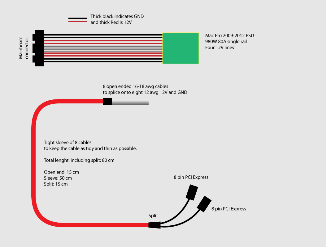

Wondering if anyone can help me out here to gather some information.
I have a 2012 Mac Pro (5,1). Have an idea regarding the power supply etc.
Do not particularly want to disassemble my Mac Pro at this point if I can avoid (main and only machine currently) to get to the info so hoping someone has access to bits already.
What I am after:
1) The connector at the end of the cables that come from the power supply. The connector is the one that plugs into the logic board (behind the panel in the ODD Bay.
2) Does this connector have any identifying numbers, text, symbols etc. on it? If so - what are they?
3) I am assuming that this connector is specific (to Apple/Mac Pro) and not a "standard" connector. If, in fact, it is some kind of standard or known connector - any idea what it is known as? (name, format type, model etc.).
I have searched and I cannot find any info (always only see the Power Supply with the cables and connector attached) and no images of connector alone where I could see type/number etc.
Appreciate if anyone has a 4,1/5,1 power supply handy that could take a look at and advise any info on it.
(Also, just thought - possibly the logic board socket part (that the connector plugs into) may have some info also - if anyone has a logic board out appreciate if you could look and advise also).
Any and all help is appreciated.

Updating my own thread with the relevant details as now have found the required info and will post here for reference should someone else need at some point.
Was able to (finally) locate thanks to other helpful forum member who provided photos in their thread when I asked (they had their PSU out to do mod). The thread there: https://forums.macrumors.com/thread...-pin-out.2122393/?post=29157895#post-29157895
Details:
The Logic Board socket (referred to by Molex as a Right-Angle Plug Assembly) is:
Part Number: 464371023
Description: 2.54mm, 7.50mm Pitch EXTreme Ten60Power Right-Angle Plug Assembly, 2 Power Circuits, 15 Signal Circuits, 2 Power Circuits, Halogen Free
Link: https://www.molex.com/molex/products/part-detail/pcb_headers/0464371023
The plug on the end of the PSU wires (referred to by Molex as Receptacle Housing) is:
Part Number: 467070001
Description: 2.54mm, 7.50mm Pitch EXTreme Ten60Power Receptacle Housing, 15 Signal Circuits, 4 Power Circuits, Halogen-Free
Link: https://www.molex.com/molex/products/part-detail/crimp_housings/0467070001
