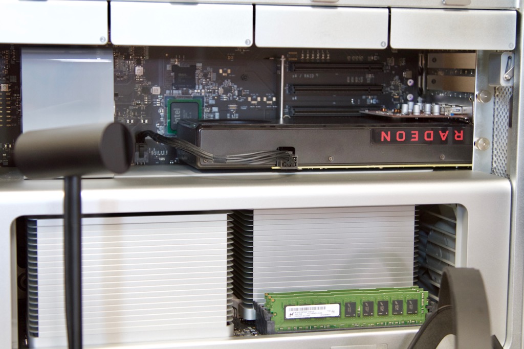

This is a weird one for me. I am not sure where to start because I am not seeing any kernel panics being generated in the Logs folder. The computer seems to work just fine when I am using it and I don't allow it to lock, turn off the screen, or sleep. I just installed the latest security patch for 10.14.6, and this may have made the problem worse.
In the past, crashes with automatic reboots have occurred due to issues with cpuPowerManagement. Now, I have no idea because my only cue to the system hanging or crashing is the hard disks shutting off. The power LED will pulse slowly like it would if it were asleep, and the fans are still running on the system.
Any attempt to wake the machine fails, no input on the keyboard or mouse will work. Pressing the power button instantly turns the machine off.
I am unable to see if there are any crash messages on the screen when this occurs, that may be because I am using an RX 580, but not the Sapphire card that supports boot splash.
I can collect any information necessary and perform any steps needed to further identify/fix the problem. I have attached the most recent kernel panic (this was prior to the security update i applied today), but the behavior of the system when it produces kernel panics like the attached, the computer is sitting idle and it probably has to do with CPU power management as I had mentioned, but it will recover and reboot to the login screen. Currently it seems to just sit on a black screen.
Thanks in advance.
