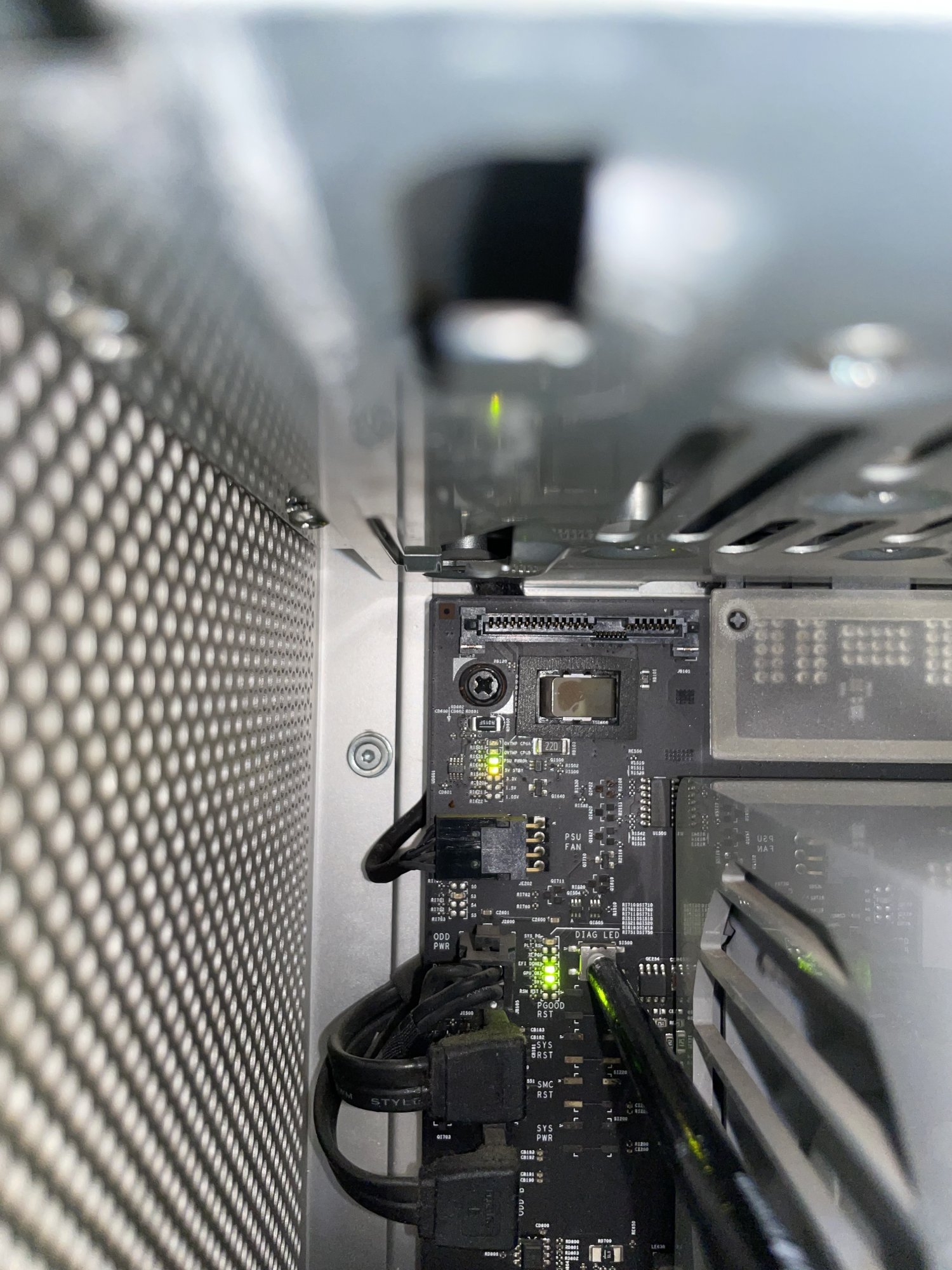

- DIAG leds show everything regular (photo follows)
- No abnormal leds lit on processor board (flashes fast at startup as it should be)
