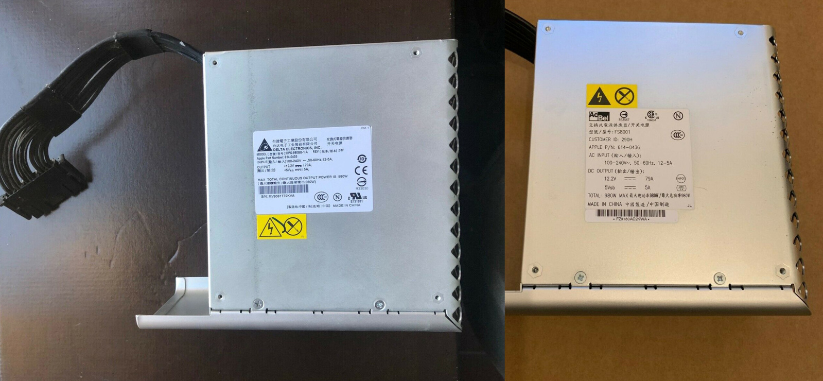

So, I've acquired from ebay a new PSU, almost identical, the old one was DELTA Part No 614-0435 and the new one is AC BEL Part No 614-0436, same output 980W. I think they are the same:
