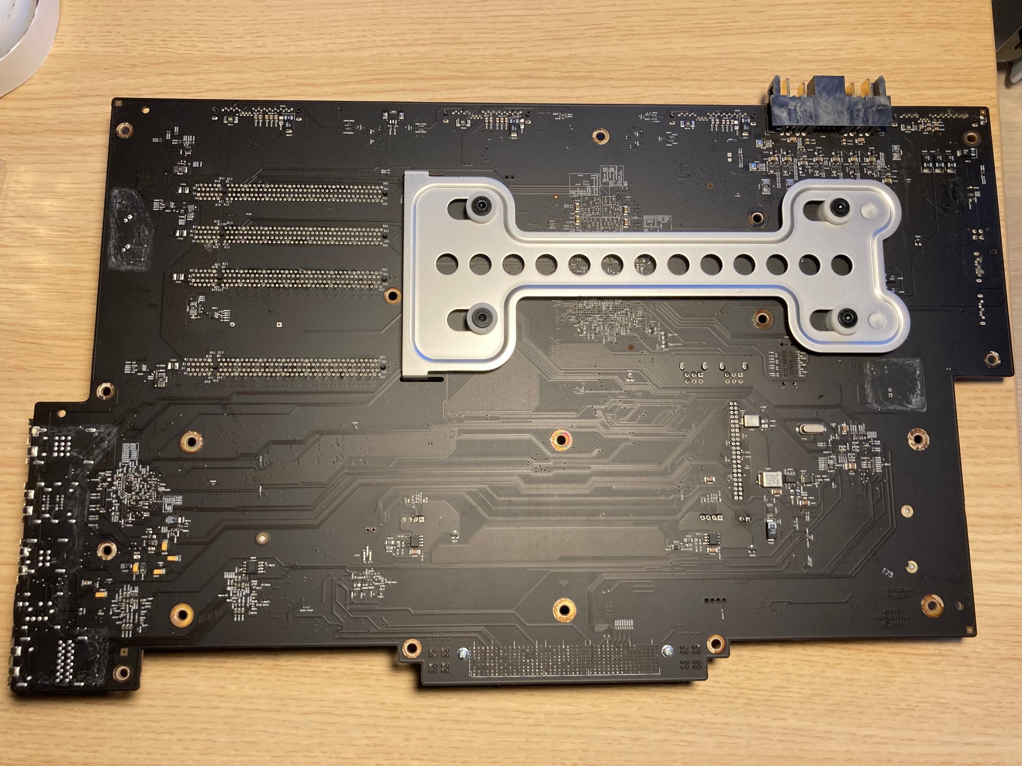

Hi all,
Recently I found the time to install a used backplane described as working (bought it from eBay). I installed it and still no luck. The issue I'm encountering are still the same: RAM chime -> boot -> login -> and restart. The restart loop then continues until it hangs on a grey screen.
I found another thread where someone has somewhat the same issue I have.
I noticed the backplane I got from eBay has the same 'flux/cap leak' marks on the back. Did I get a defective backplane?
Here's a picture of it:
Could it still be the backplane that is causing this issue? As of right now, I have no idea what could be the problem. If anyone has some suggestions, please share!
All the best and a happy new year!
Cheers!
Hi all, my Mac Pro 4,1 is working again!
@tsialex suggested I replace the PSU, and I got a refurbished one from eBay, and it's working now!
I think it was a combination of a faulty backplane and PSU.
Before I replaced the backplane, I could not reset the PRAM anymore. When I replaced the backplane, I could get the PRAM to reset, but it would still shut down after logging in. When I then replaced the PSU, everything started working again!
