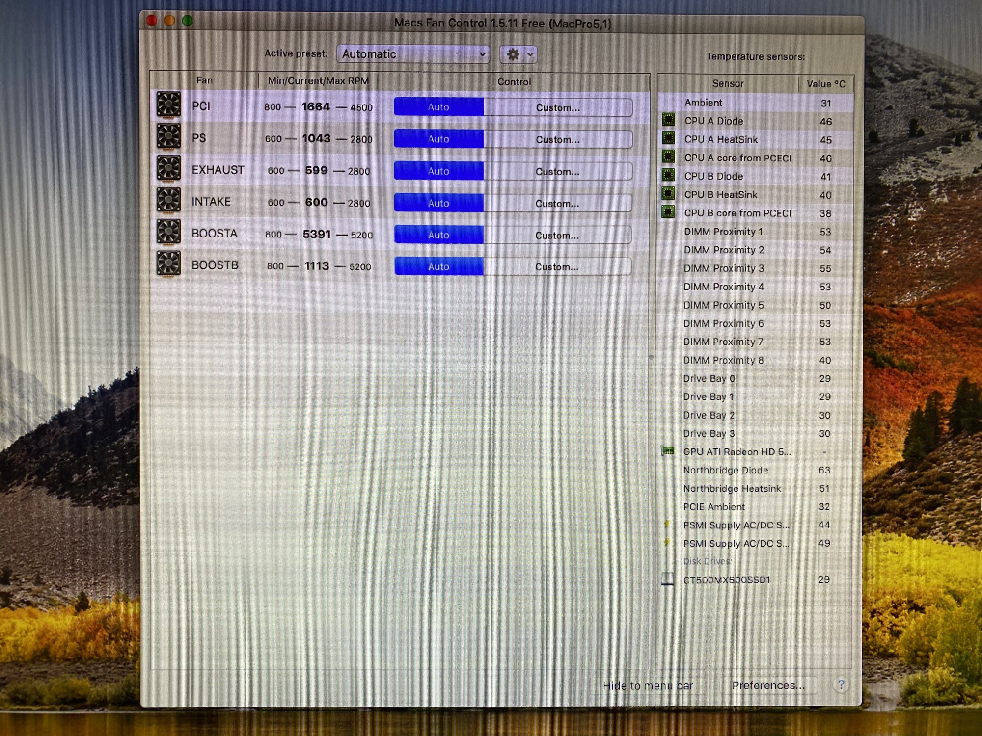

I have just purchased a Mac Pro 4,1>5,1 with 2 x X5690 plus 128Gb RAM. Clean Install of High Serria
One of the fans is running at full speed so downloaded Macs Fan Control and found the BOOSTA fan is the culprit.
I tried slowing the fan down using Macs Fan Control but it doesn't....
All the temps look OK
I've reset SMC and NVRAM
Starts running at full speed as soon as you with it on.
Ran AHT and got the error 4MOT/1/40000003: BOOSTA-5351
If the fan wasn't working I could understand there being a fault with it but given that it's running I'm not sure.....
Any ideas please?
Cheers

The connector in the CPU heatsink is a 6-pin for both the Boost fan and the sensor.
Sensor reading is working , so that's not the culprit.
There could be a short between pin 1 and pin 3 , somewhere in the fan cable/ the fan itself.
That would explain the fan running full speed.
As suggested by @Macschrauber I would remove the heatsinks and check for delidded CPUs and double check the connectors on the heatsink.
You could measure with a multimeter if there is a short between pin 1 and pin 3 on the connector of heatsink CPU A (the one on the right side at the back).
Perhaps the cable wasn't routed correctly when the CPU upgrade was done and/or got damaged , so look for physical damage to the fan cable .
