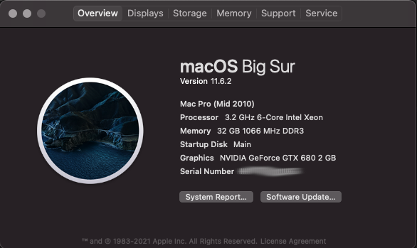

I have a 5,1 with a 3.2Ghz hex-core, 32GB of RAM, Mac-flashed GTX 680, and a Kingston 512GB SSD as the boot drive. Been running Mojave for the last few years and finally decided to go the OpenCore route the other day and install Big Sur.

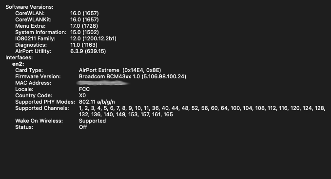

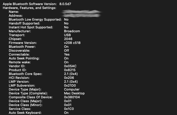

Hi
could you tell me which is your BT and Wifi card?I think that me wifi card and yours is different.
Regards
Here:

Thanks a lot.
All is the same except for CPU and GPU (but my GPU is Metal Capable too).
I don't know which is the difference between both installations.
Is it possible that you guide me?
I have reviewed several threads about this and the only thing that somebody tells me is that my GPU is unsupported in Big Sur.
