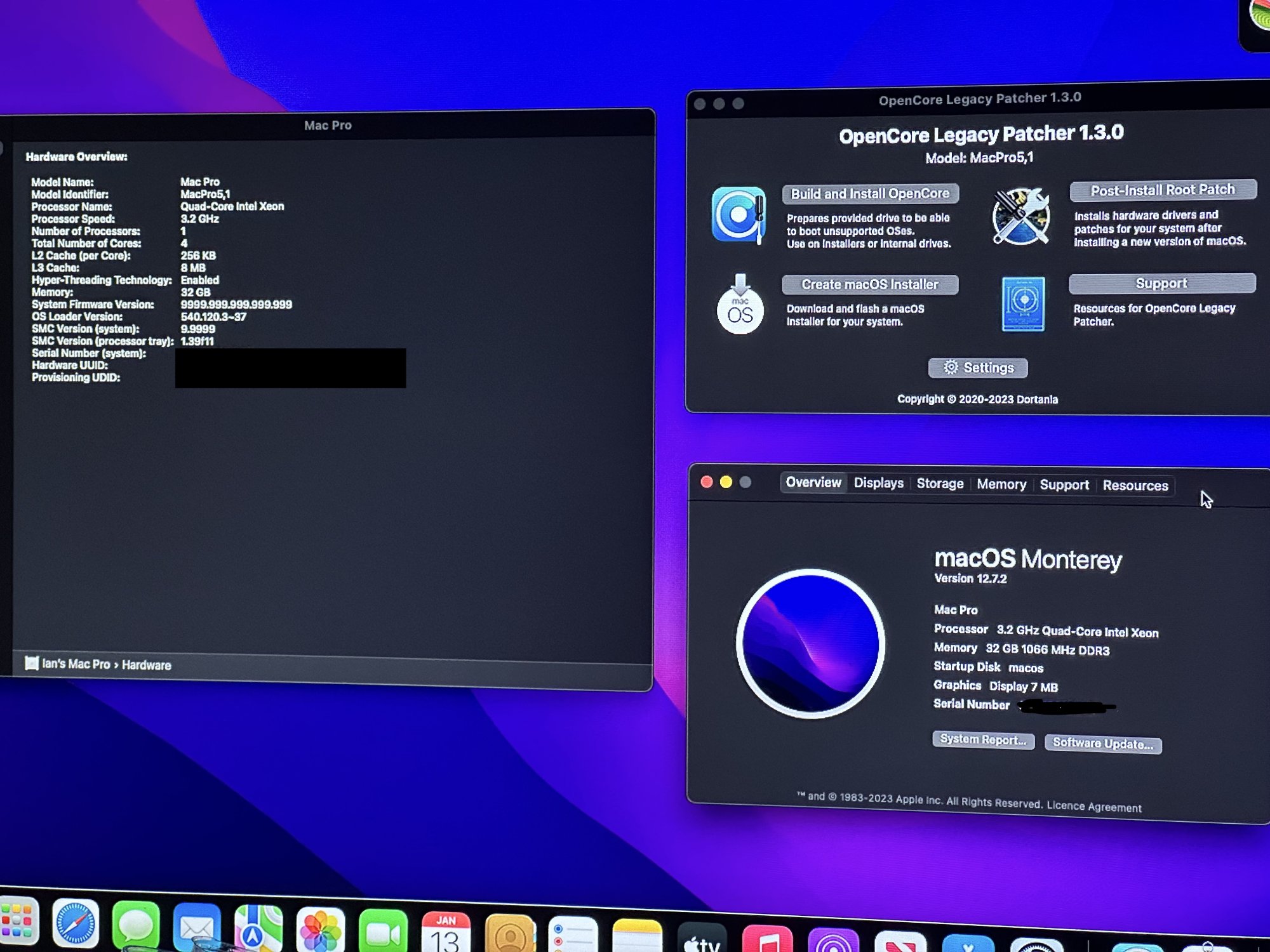

It's taken the best part of the day but I've now got Monterey installed on my Mac Pro 5,1 with AMD W5700, I pretty much followed the install from 'Opencore Legacy Patcher' however I got stuck in a boot loop and ended up resetting nvram 3 times in a row.. after that it wouldn't boot at all so I installed my GT120, started everything up again, then the installer started but crashed after the second screen (after language choice), so I swapped the W5700 back in and the installer completed but the UI was very slow.

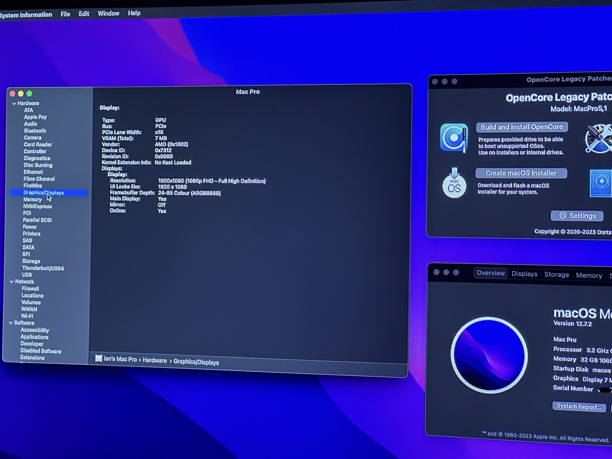

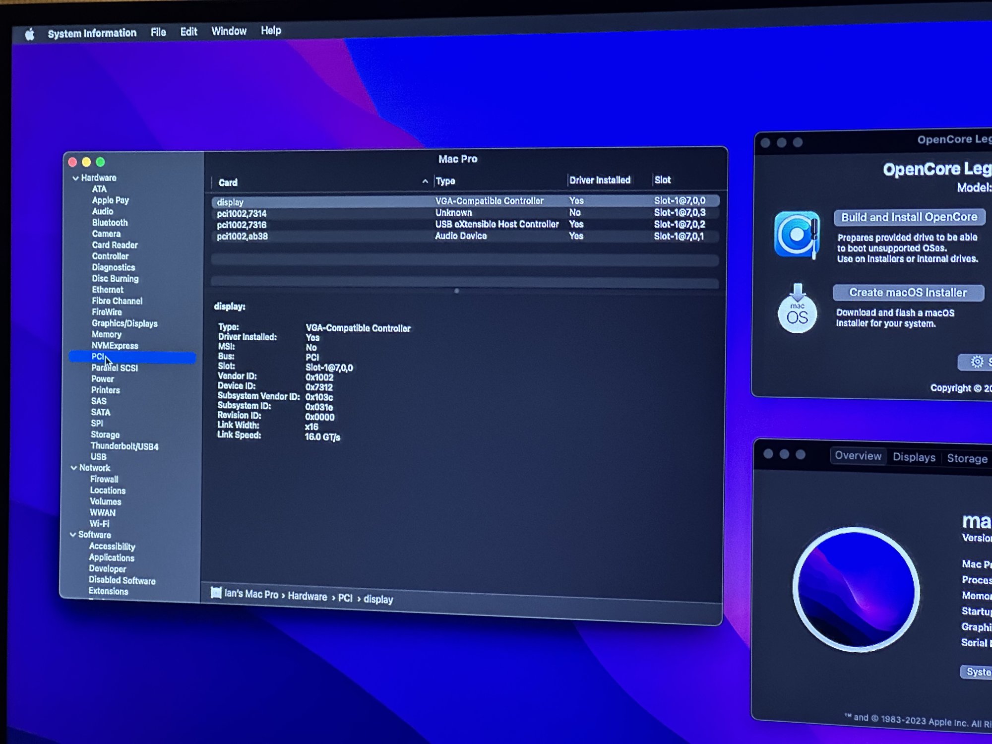

Now the gpu is showing as 'No Kext Loaded' and performance is degraded, effects etc.. are not working.
I was under the impression that the W5700 driver was built in to macOS Catalina and above, is there anything else I need to do to enable this GPU, have I screwed something up in the install by using the GT120?
Is there anything I can tweak in Opencore or can I manually download / extract the drivers from the macOS installer?
I'm kind of stuck as to the best course of action, any pointers would be greatly appreciated!
Here's some shots of the system info just after the install.
I have noticed that I do not have some relevant looking kexts in the /System/Library/Extensions folder
AMDRadeonX5000.kext
AMDRadeonX5000HWServices.kext
I’m not sure if they are meant to be installed by Monterey and somehow they were missed.
I’m going to try extracting them from the installer and copying over manually.

System extensions are in /System/Library/Extensions/
You might want to use OCLP to reinitialize EFI with Build and Install OpenCore since that looks at your configuration. You will not have to reinstall macOS.
As a precaution, after a reboot, you can also check Post-Install Root Patch to see, whether you need that. You likely do not.
