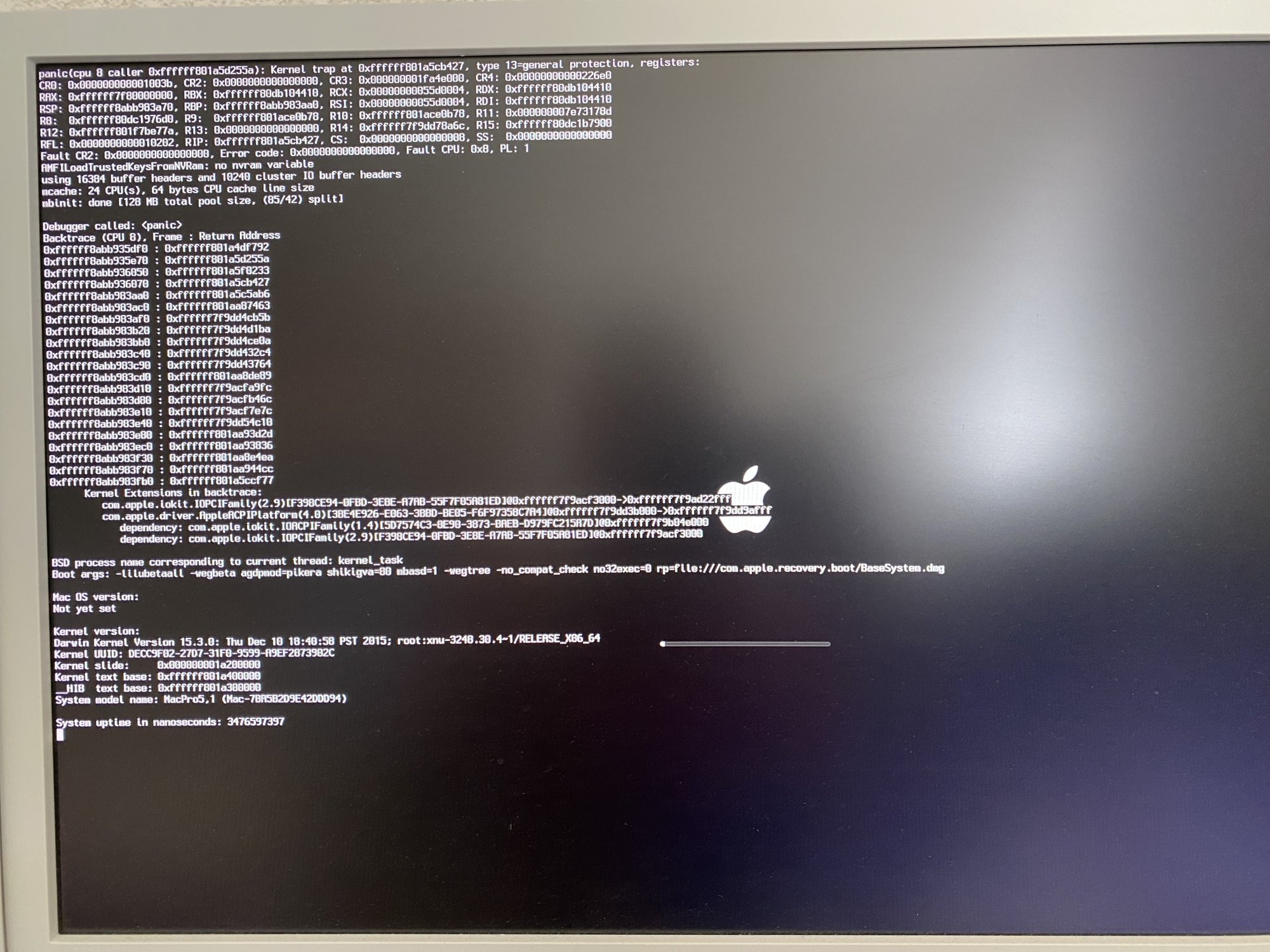

Good day. My Mac Pro 5,1 had a glitch yesterday, restarted and then restarted itself straight away again. After that, I couldn't make it start up at all. The machine is a 3.46 dual upgraded one, running 2TB Pcie NVME startup drive, Crucial 2TB MX300 for general storage, and other HDD's for movies (FCP). Memory is two banks of 3 Hynix Dimms.
I'm running Mojave via Opencore. I have a bootable USB stick for emergencies, along with new sortware on that USB stick. The machine would boot from it before, but now it won't even display it when I boot up whilst holding the 'Option (alt)' key.
The screenshot below is as far as it'll go when trying to boot (from recovery on another installed drive.
Any ideas would be greatly appreciated?
Many thaks,
Mike.

Anyway, it's Mojave I'm running, with the patcher. The attached image here is the USB stick I have with patcher and Mojave installer, which I used a few years ago when I fitted the NVME. WHen I try and boot the machine up though, it won't even see the USB stick as a bootable drive for some reason. Even if I remove all the other drives, it still won't see it. :(

based on the message "no nvram variable" I think you just need to do a bunch of NVRAM resets. at least 5 times. so as long as you have a natively supported graphics card and a wired keyboard to hold down CMD/OPT/P/R for a while.

The nvram message is just an unset var in NVRAM. But anyway, checking battery (below 3.0 Volts, built in = replace) and clearing NVRAM does not hurt, to troubleshoot.

I replaced the battery yesterday as it happens, but only held the power button during bootup. I'll try what you've suggested (holding keys down). Graphics is Radeon VII 16GB I think.
