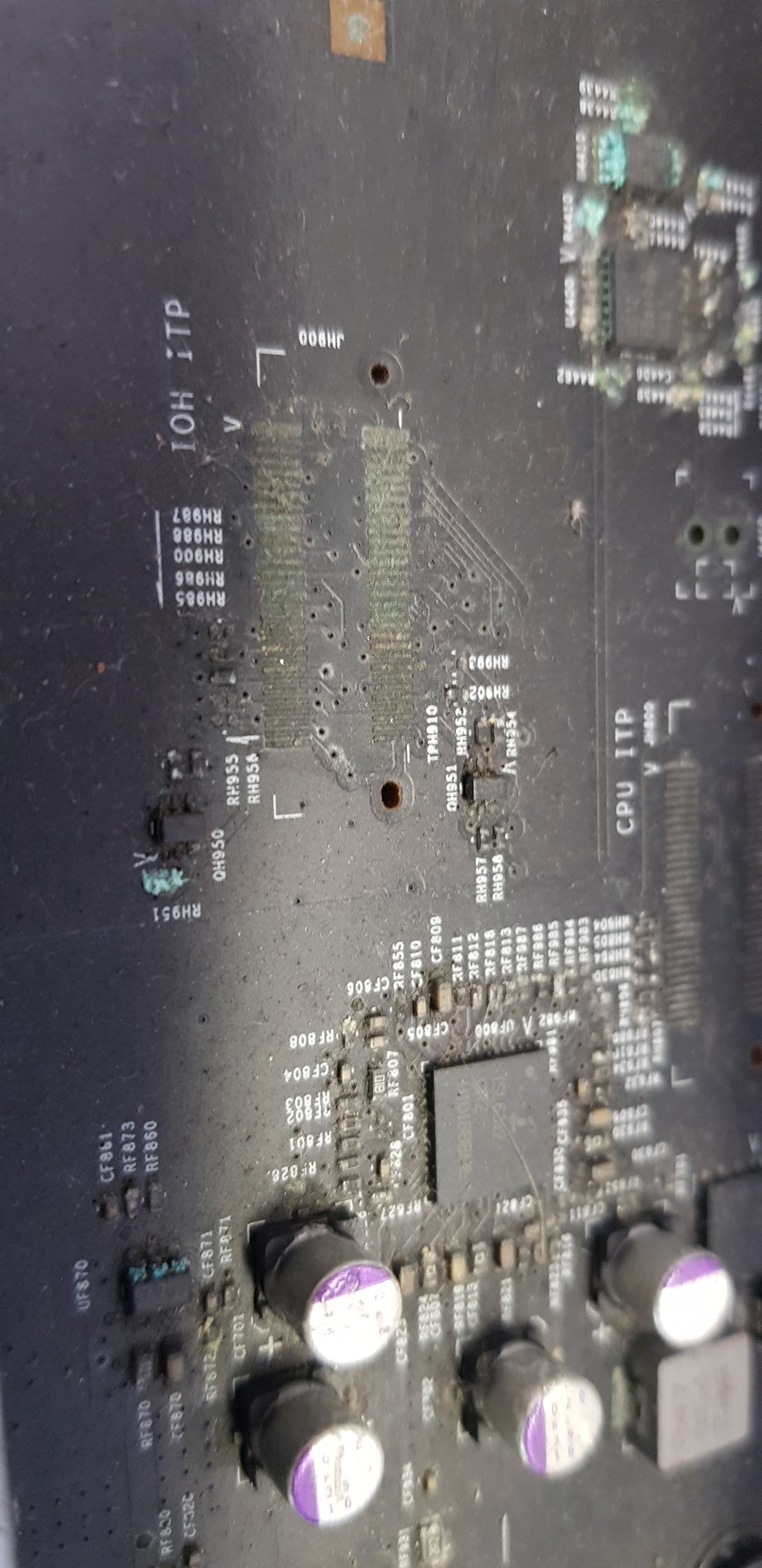

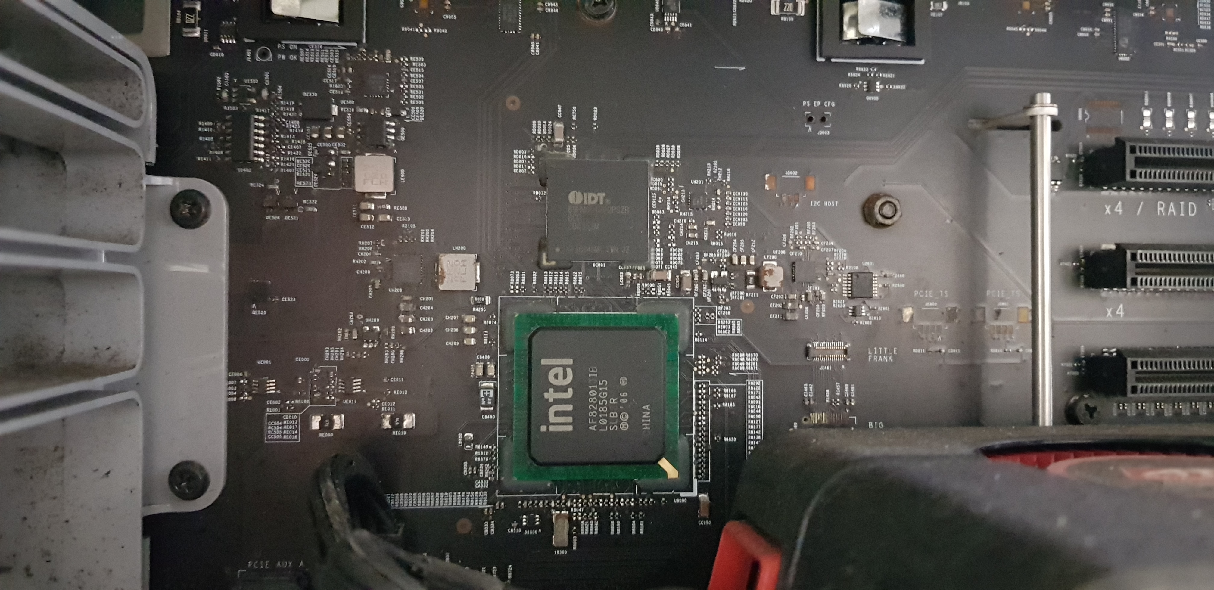

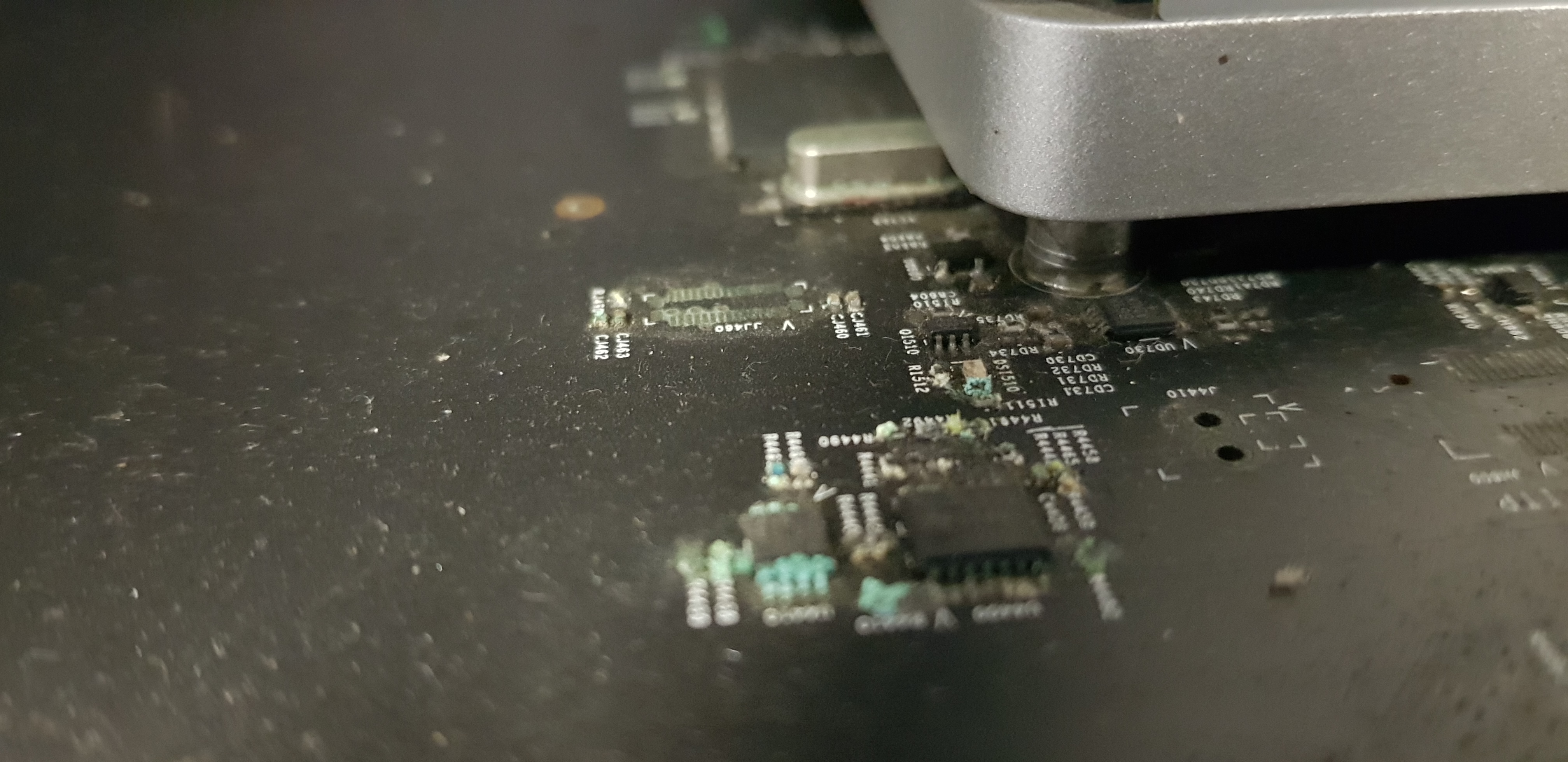

Did you checked if you have any corrosion on the backplane and CPU tray? Usually where humid air circulate near exposed PCB areas and components. Corrosion can cause your symptoms.
Just spent half of the morning disassembling the Mac Pro and checking for sign of corrosion and I didn't find any. Should those be small spots or something easily to see/identify?
Anyway thanks for the suggestion.
This is a extreme example, a far gone 2010.
