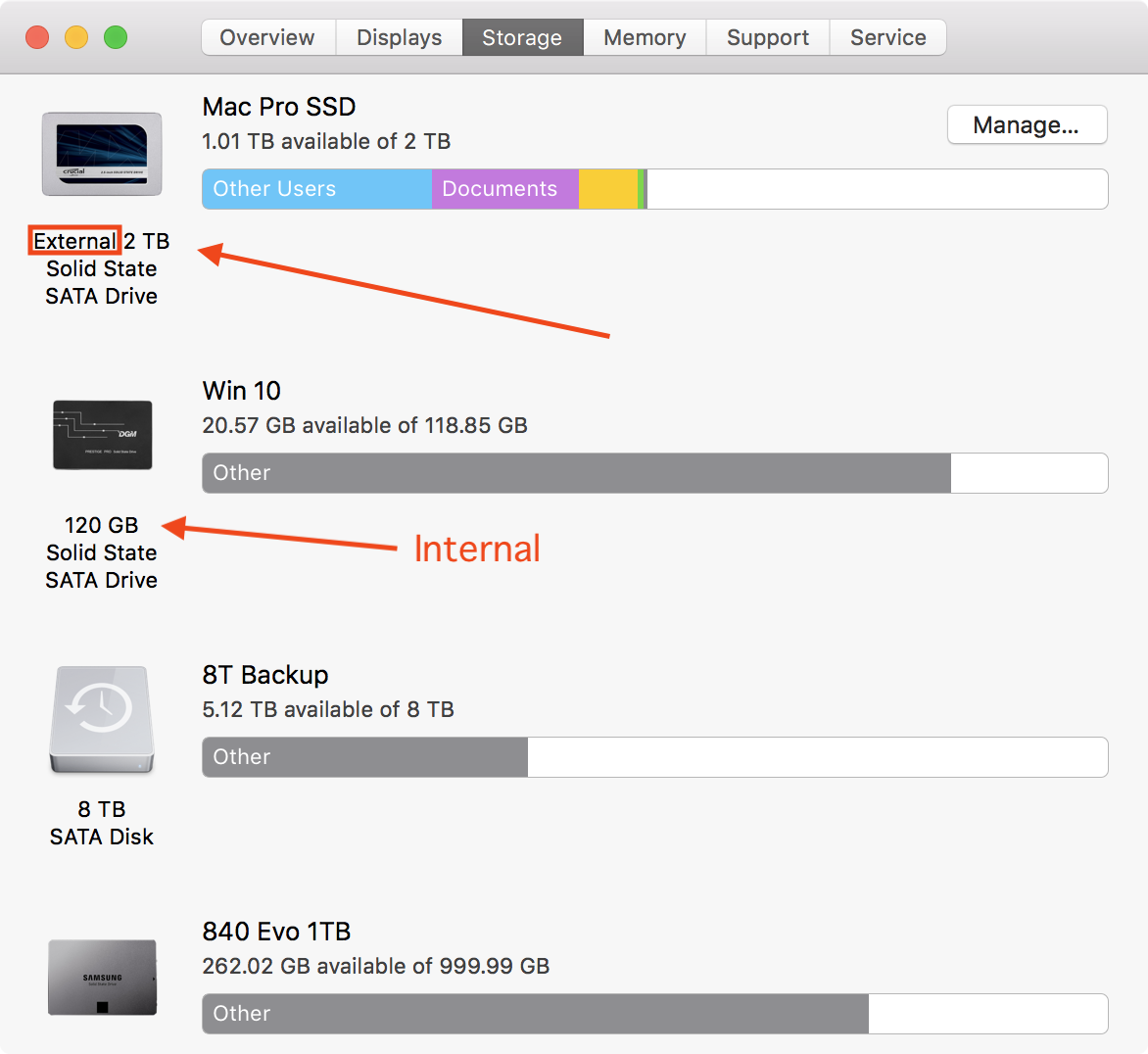

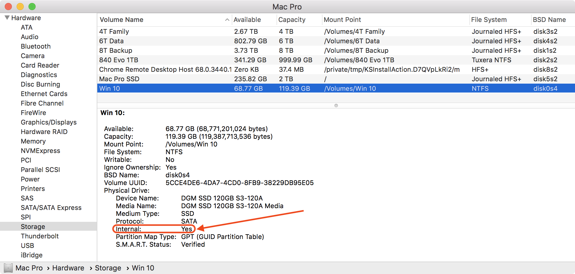

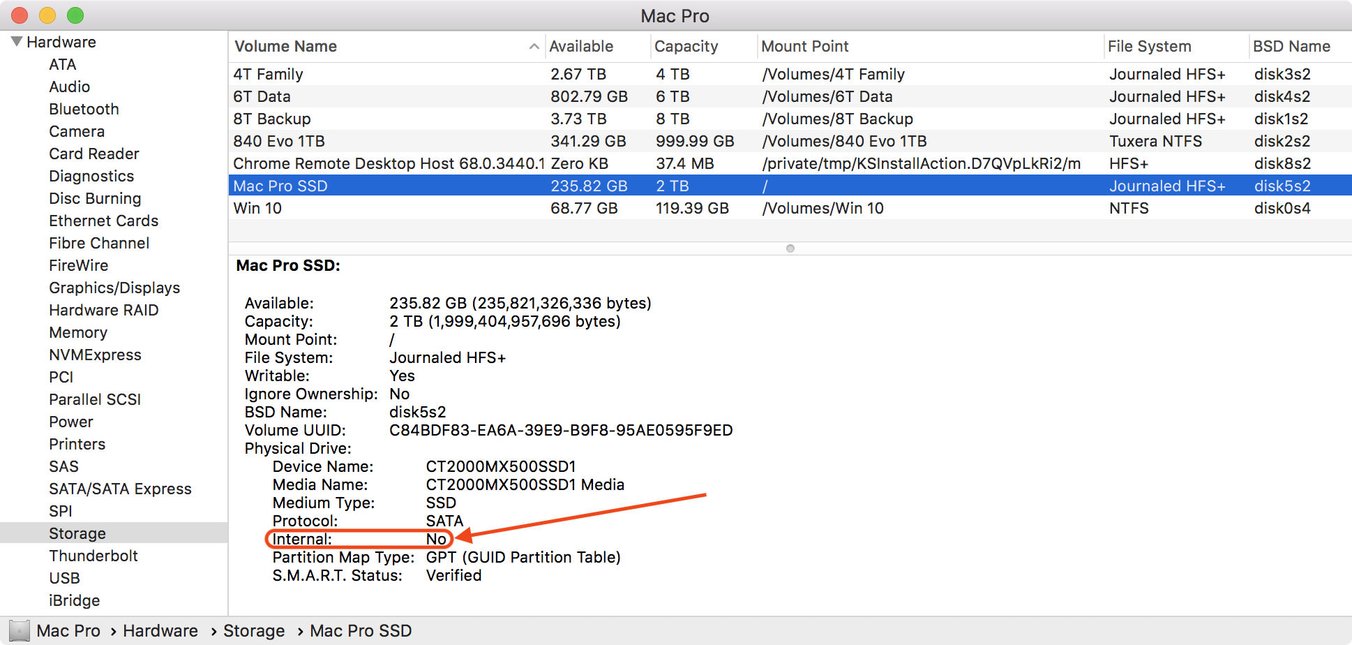

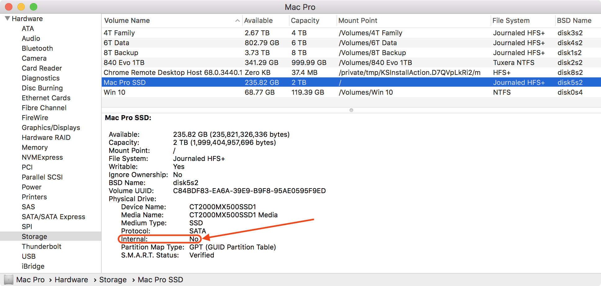

Not really. When installed via the onboard SATA II port. The drive will not shows as external.
My MX500 is mounted on a Tempo SSD PCIe SATA III card, which shows external. But the DGM is mounted on a onboard SATA II port, and shows internal.

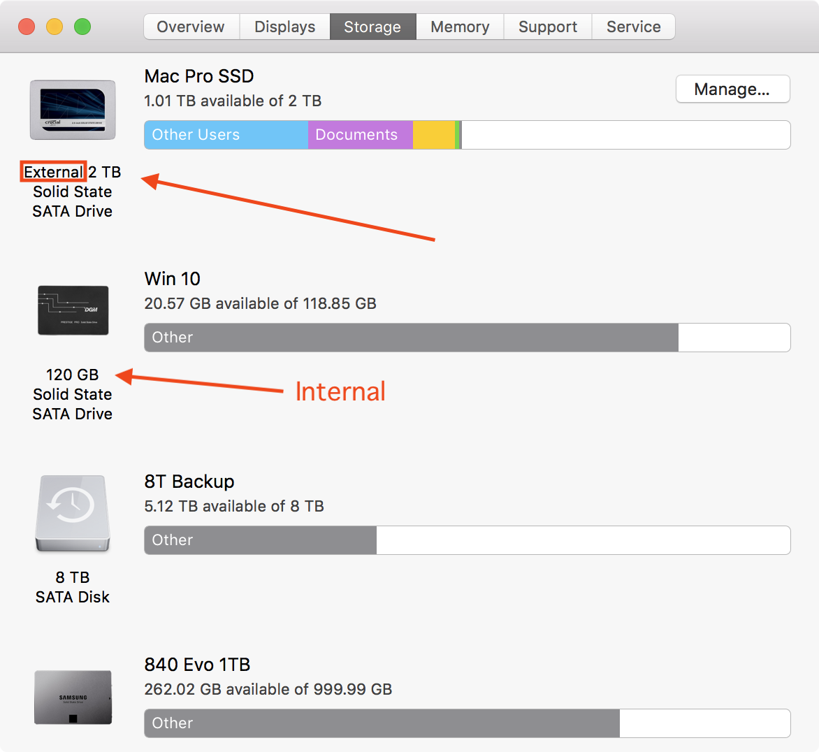

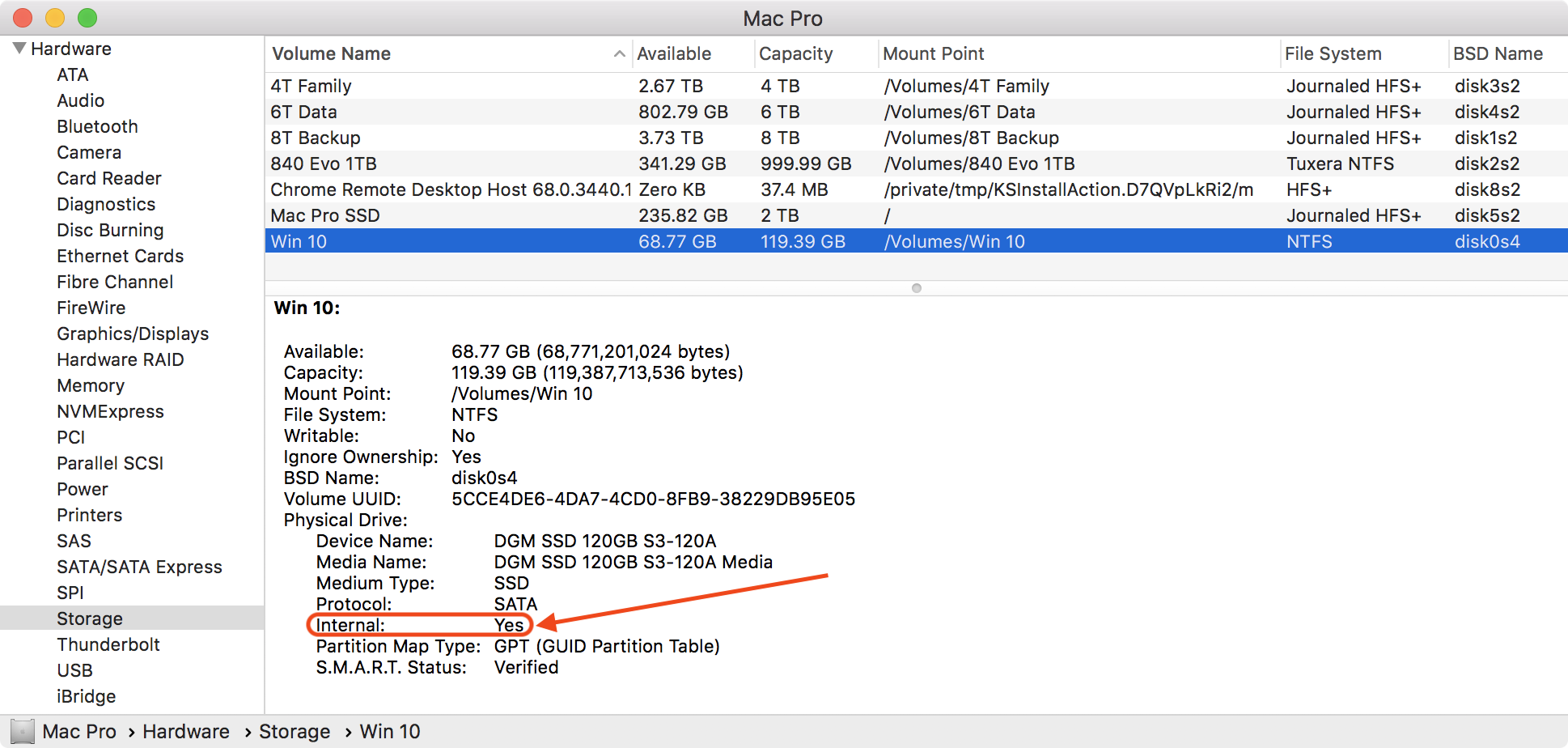

I think you misunderstood my post. Simply put, I intimated that if it’s on a PCIe adapter, it’s going to show external. If it’s on a cMP port, it should show internal.
The way I see it is like this... The cMP came hard wired for 6 internal SATA connections. If it’s installed by way of anything external to those 6 connections, it’s normal to consider it an external drive.

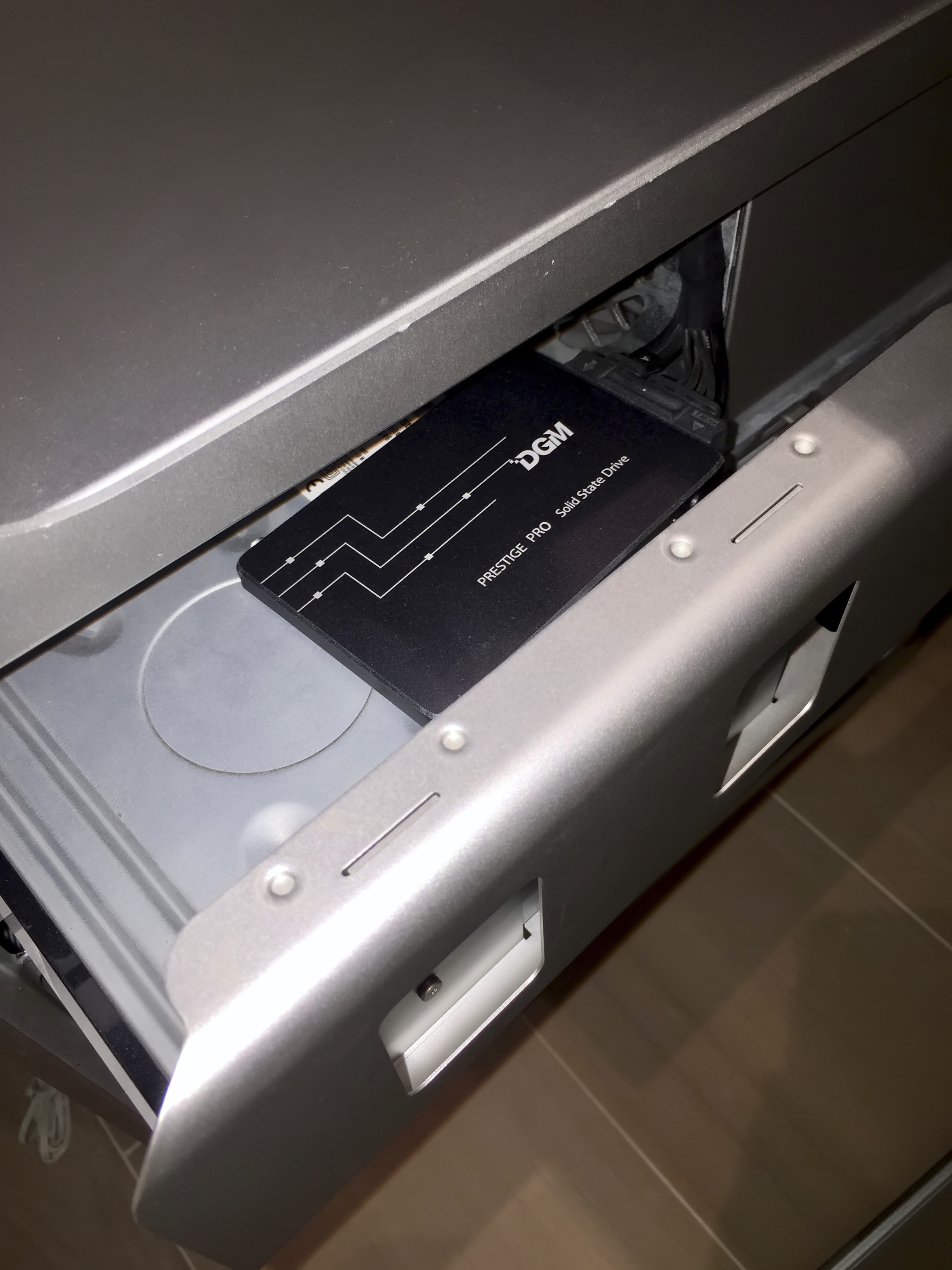

I ended up just putting it in the second optical slot. I wanted OS X and Windows on the same drive so...... Benchmarking produces markedly slow performance, but it's still pretty damn fast.....it's on par with boot tests of even nvme drives in PCs, so I think it's one of those things where in real world application it doesn't matter as much as the benchmark might indicate. Maybe you'd see a bigger difference in downloading files and such though.
