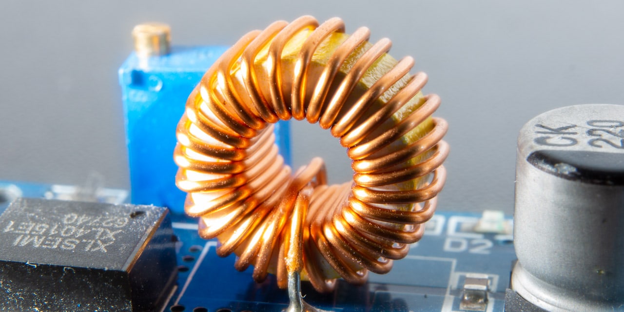

If it's not the fan, which I'm assuming it's not, could be capacitors, inductors, or coils emitting noise. Can't help you much further than to provide the following link which might help you diagnose what you're hearing.

My machine makes a faint hum from the PSU whenever it’s plugged into live power (240v through a UPS), and has done for the ~ 8 years I’ve owned it.
