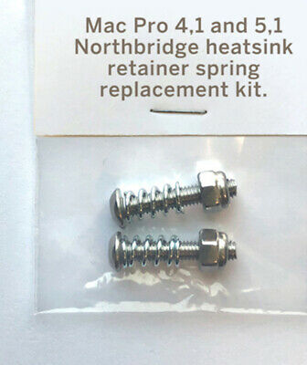

NMI errors 99% of the time are caused by the CPU tray. First thing to check are the northbridge heatsink push-pins.
I pulled the northbridge and repasted it, I need to buy new bolts. What size are they? Plus one of the springs is missing, any particular size I have to buy?

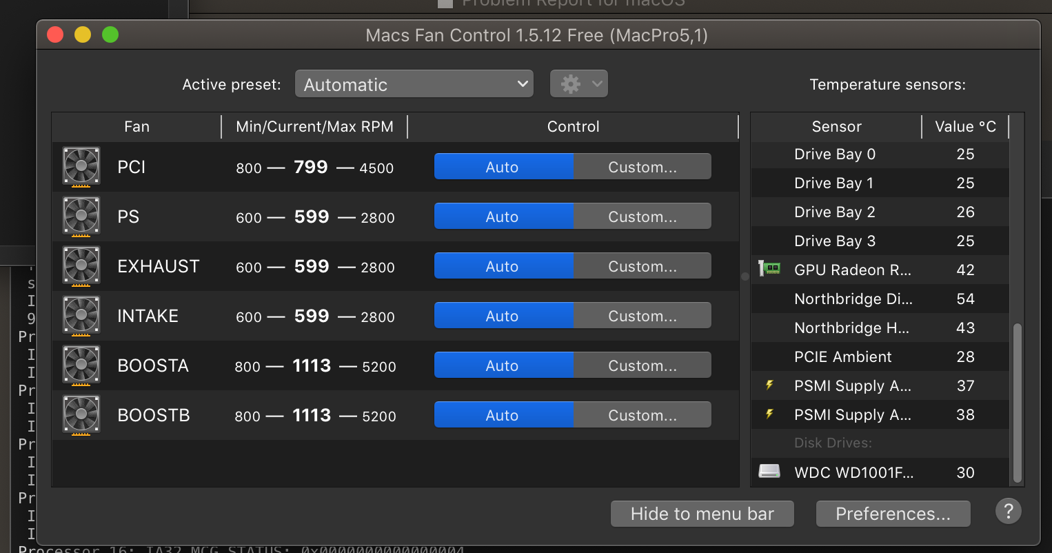

If you are getting these NMI errors, have a look at the Northbridge heatsink to make sure it is secured properly, watch the temps on it (if the computer will stay on for long enough), if it needs thermal paste then do that again.
