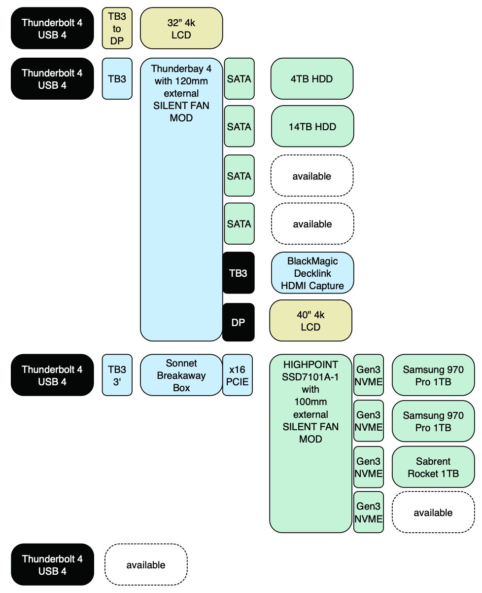

Going down the same path recently, I decided to avoid the well documented problems associated with USB based Hard Disks on the Mac Studio and opted for a Thunderbolt 3 based solution with the OWC Thunderbay 4.
Be warned, any external hard disk solution is going to introduce fan noise into your environment. I opted to remove the 92MM fan in the Thunderbay 4, replacing with an externally attached 120MM fan that reduced noise > 90%. Noise from the HDD's was not reduced.
Coming from the Mac Pro, I also have 3 NVMe SSD's that I wanted to leverage in my Highpoint SSD7101A-1 carrier. To orchestrate that move, I picked up a decently priced, slightly used EGPU enclosure and after I modified the 7101a with an externally mounted fan, it's also completely silent.

Thanks for the rep,y and the details. Maybe someday I’ll progress to a configuration like this. I am looking for something with fewer devices. In additional to my built in 2Tb drive I want 2-4 bay storage, SSD or platters to hold all my photos and Lightroom catalogues as well as music. All will be backed up with Time Machine as I currently do with my Boot Drive and 4 bays. Any suggestions.
