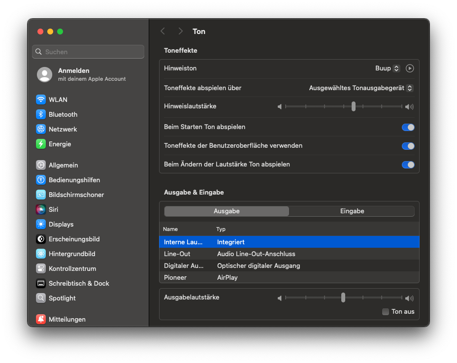

Sequoia has been running without any issues since I installed it with OCLP except for my audio.
I get sound from internal speakers but not through my line-out or HDMI on my Asus MX299Q. I had the same issue with Maverick but was able to solve using Soundcontrol but nothing is working this time on.
Any help with resolving this issue would be appreciated.

no, You should adjust that with the pref pane. This is german, but you will find it by comparing the lines:
set it to line out.

I tried that and I get no sound from line out or HDMI through my monitor
hook a headphone to line out, set volume to 100% and double test
Interesting, so I plugged in the line out to my jambox and it works 👍👍. Yet when I plug the line out to my monitor (Asus MX299) it doesn't work nor does audio through the HDMI that is connected to the monitor. I guess I need to troubleshoot my monitor even though it worked with previous OS with soundcontrol.

HDMI sound is another topic, what needs more fiddling. For analog sound your display should have a setting in its menu to activate.
