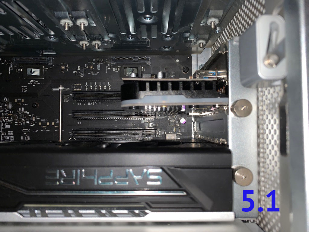

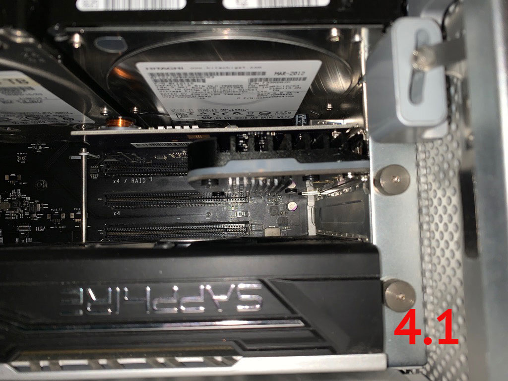

I have installed some RX580 and I noticed that
the 4.1er has less room to move the PCIe slot2 is more than original 5.1er
but you can see that the 5.1 has more room
the cards are the deepest pressed to tighten the screws
and therefore also the holes could be different
but also on the far left you can see a difference
the insulation plate could be of different heights, but i haven't measured that yet.
