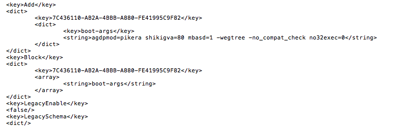

Take a look at this thread - Caution! Troubles with 870 evo drives on cMP 5,1 !
You can add -no_compat_check to the boot-args of the config file of OpenCore to boot High Sierra.
Thanks for your reply.
I'm pretty new to OpenCore, but this is how it looks in my config file.?
