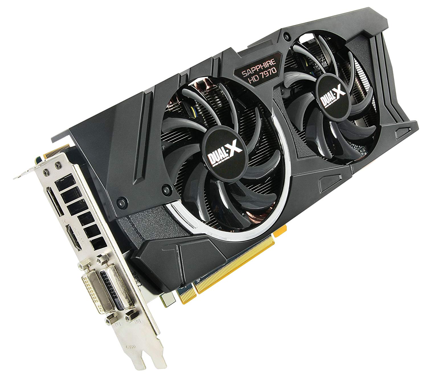

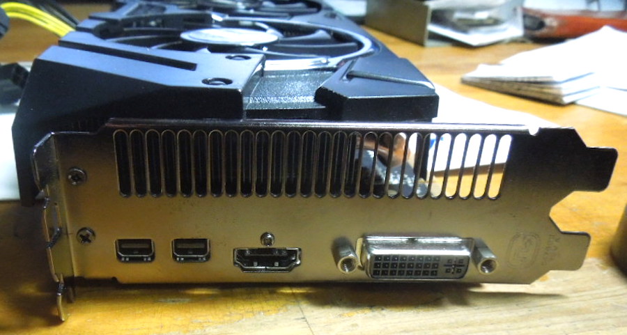

The Sapphire Dual-X HD 7070 3 gb can be EFI flashed ( I have one - flashed ) and will run Mojave with EFI pre-bootscreens. It also has the DUAL BIOS switch = very handy !
If you buy one I have the flashed EFI ROM if you need it.
Not as fast as an RX 580 8gb but still very respectable.

As you already have an HD 5770 flashing a Sapphire Dual-X HD 7970 would be pretty easy.
