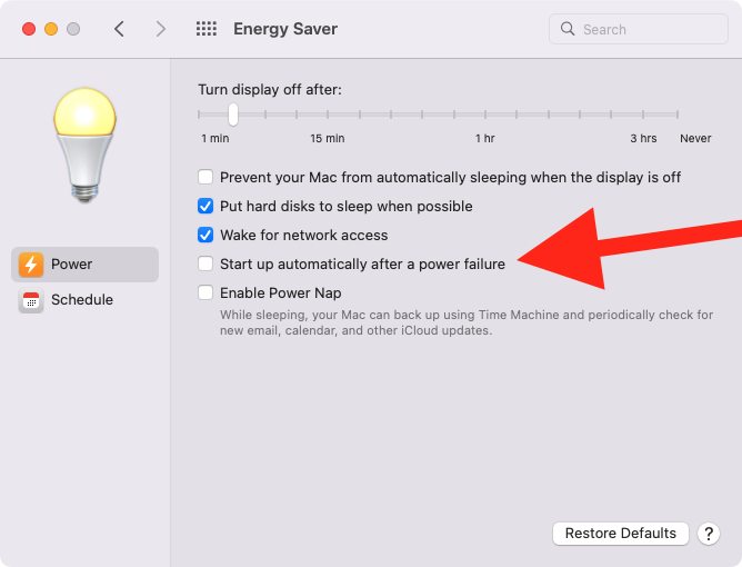

automatic turn on when plugged in
You can set the RTC to power on automatically when the power is restored.
