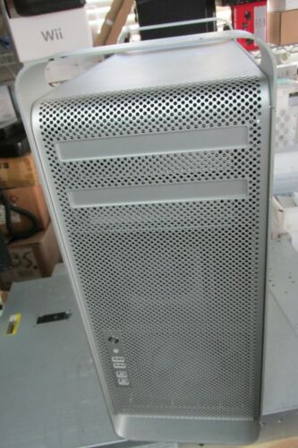

Isn:t it easier?
APPLE MacPro 4,1 A1289 XEON 2.66GHZ QUAD CORE / 16GB/ 2TB tower
Pre-Owned
JPY 32,010 (~$300)
From United States
or Best Offer
Customs services and international tracking provided

In my opinion, better to just purchase a fully working 4,1 2009 cMac Pro. It’s understandable $70 is cheap, but you never know other hardware parts might also be defective or not working that buying the parts separately might turn out to be more expensive and too much hassle.
Years ago a fellow colleague purchased a 2009 dual processor cMac Pro for $160. The seller said CPU A wasn’t working. He purchased another 4,1 2009 processor tray but the computer still would not turn on and boot. After several days of “headache” trying to find the issue, the power button board section was the problem as it was defective. Second problem is he had a difficult time finding a power button board for sale. He ended up buying an empty enclosure with the power button. He felt he was better off to just get a working cMac Pro.
I feel like this may be right. If I can find a fully working 09 for cheap I think that'd be the move.
