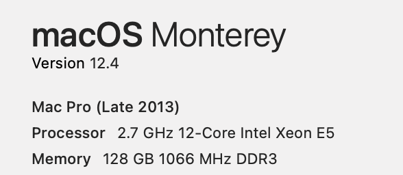

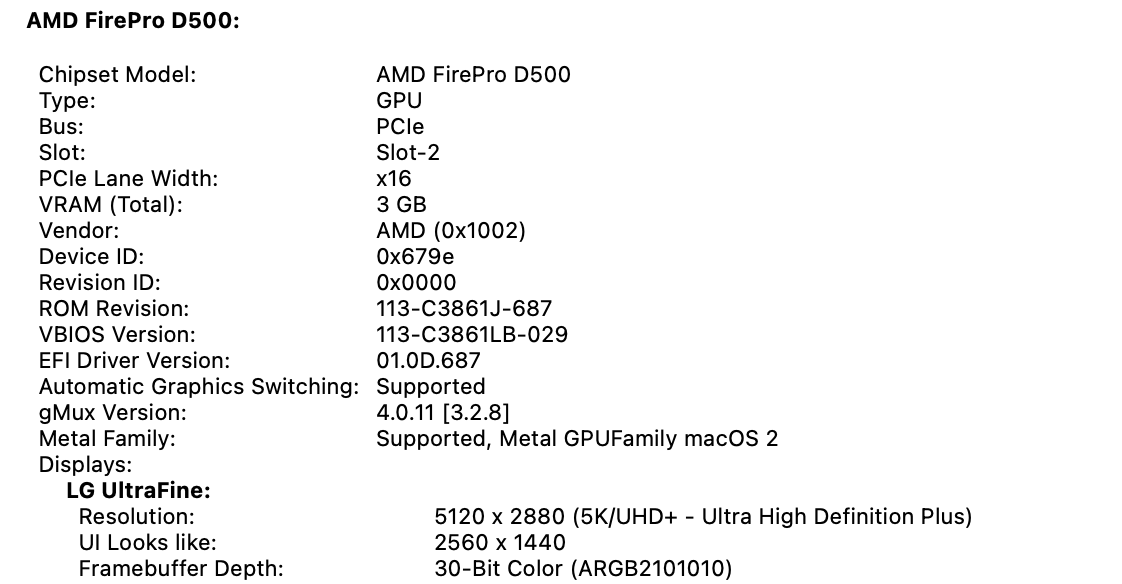

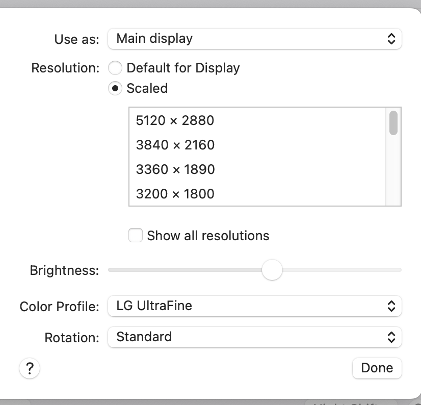

I have a Mac Pro 6,1 with an LG 5k Ultrafine (27MD5KL-B)
monitor running Monterey. I have a thunderbolt 3 to Thunderbolt 2 adapter from apple and connect it directly to my Mac. I am able to get the 5k resolution.
Your graphics cards are rendering in 5k. Your screenshots will be in 5k. But Thunderbolt 2 doesn’t have the bandwidth for 5k. So what is happening is your GPU is rendering at 5k, transferring at 4k, then the monitor is upscaling to 5k.
So really you are getting upscaled 4k on your 5k display. There are a lot of threads on this, if you want to poke around a bit.
Reactions: Amethyst1
macOS only reports the framebuffer size. It does not report the output resolution. Use SwitchResX to view the timing info of the current resolution. It will say: Active pixels 3840x2160 Scaled to 5120x2880.
Perhaps you've never seen real 5K before and therefore didn't notice that your 5K display is blurry.
Thank you for the reply, When I have an Apple Thunderbolt Display next to it, the LG looks pretty sharp =).
