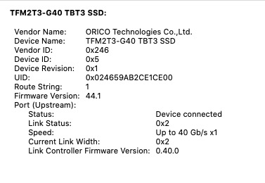

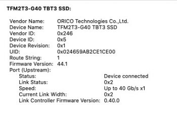

Where are you getting this from? They've been highly regarded in the media, and I'm very pleased with the 4TB Thunderbolt 3 drive I put together using one of their drives.
