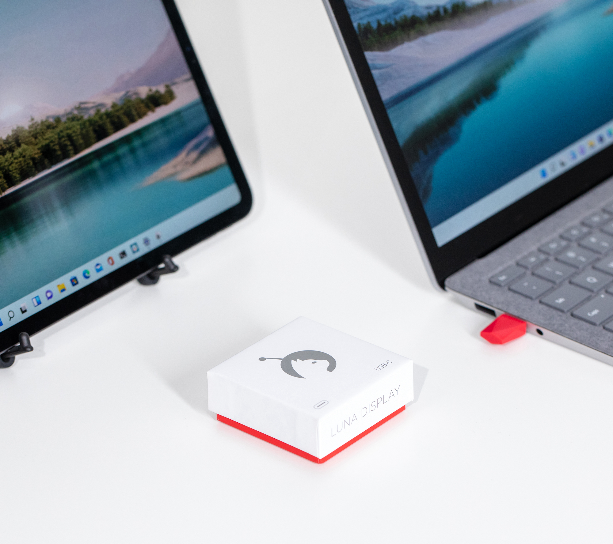

As an alternative, you can use some hardware/software combo:
I believe it will use the DisplayPort signal generated by the Mac Pro GPU and transmit it to the iMac where software can display the image on the iMac screen.
Since the source is DisplayPort, it will not affect performance of the source computer, and there will be full GPU acceleration as if you were connecting a real display.
Since the output is USB or WiFi, there will be some latency (16 ms) and maybe some compression artifacts (I have not tried this product).
The output does not support 5K resolution.

I have not tried this, but here’s a possibly viable option: output a 4k picture via HDMI from mac pro gpu, input to imac using a 4k hdmi caputre card via quicktime, new movie recording, to input from caputre card. search amazon for “hdmi 4k capture usb 3.0” for current products. Luna uses compression, so even though its good there will be lost frames. It is a good product for basic applications.
