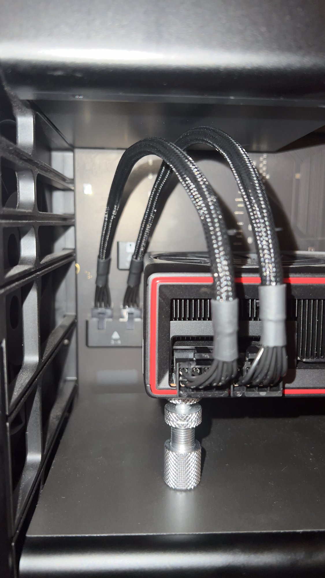

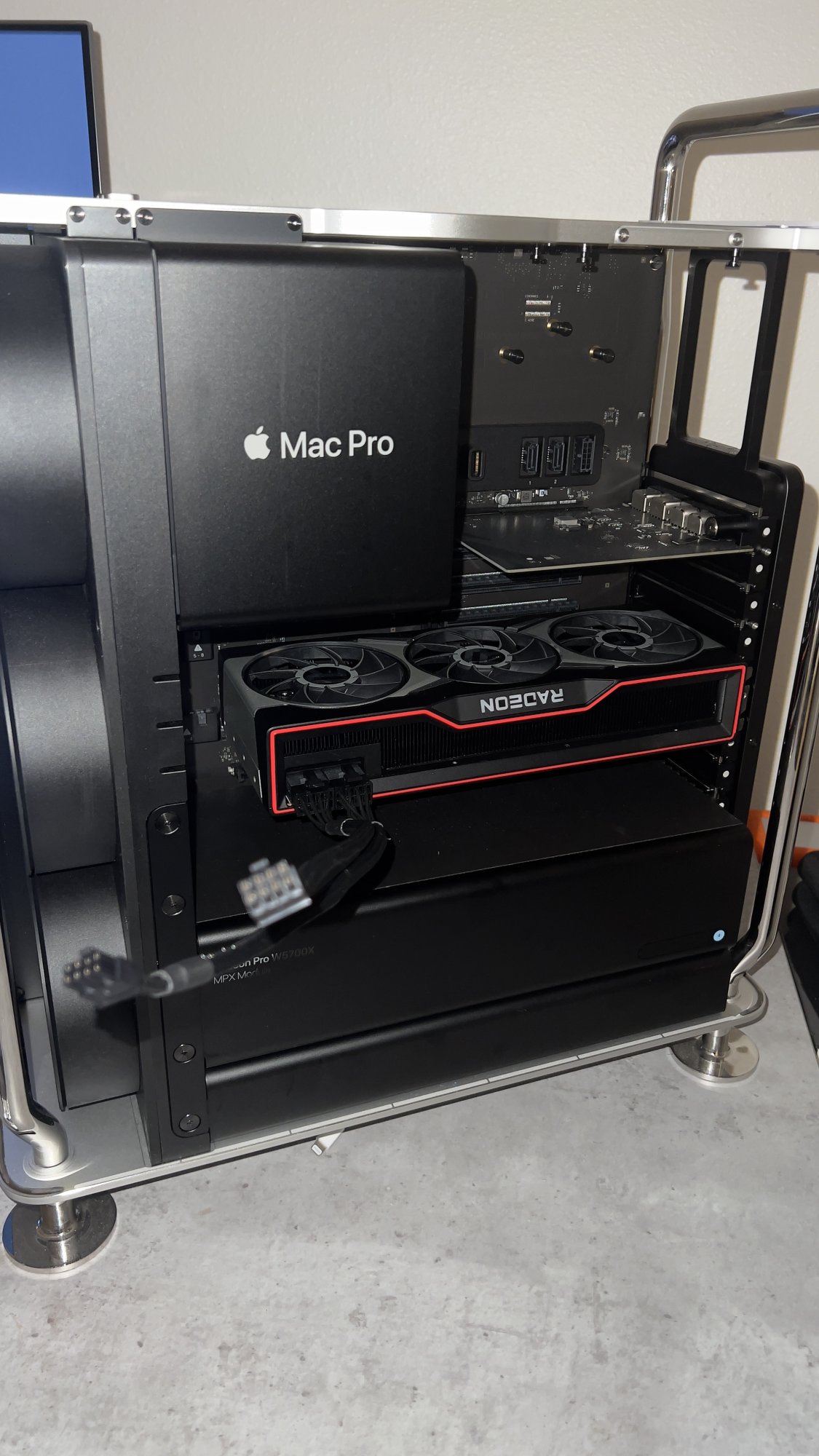

I recently brought a 6900 XT to render in Redshift. Everything works fine in the OS, GPU is supported and I can browse and file etc...
However as soon as I render in Cinema 4D/Redshift my screen goes green/black and my system shuts down and restarts.
(I have also re-intsalled MacOS/tried different versions of the software/and removed hardware one by one.)
I noticed that when I render using the 6900 XT the power goes all the way up to 200-300w and then the system turns off.
So I think maybe this could be a power spike issue however surly not because the PSU on the Mac Pro can handle more than 1 or 2 gpu’s at a time? Plus I tried only the Radeon 6900 XT in the Mac Pro by itself and it still happened.

Mac Pro 7,1
macOS 13 - 13.2.1
3.2 GHz 16-Core Intel Xeon W
128 GB 2933 MHz DDR4
AMD Radeon RX 6900 XT 16 GB via two Belkin 8-pin to 6+2 pin power cables.
