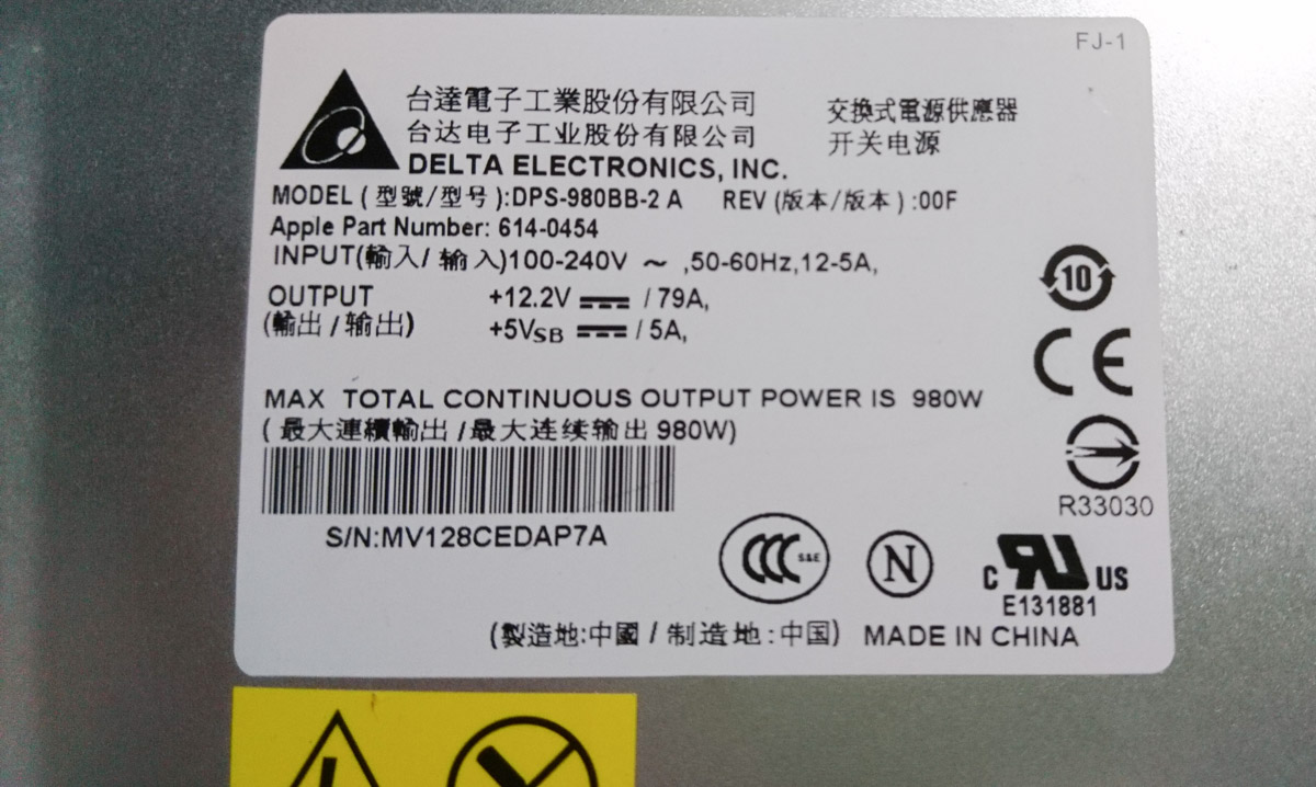

When you remove your PSU, please upload a photo of the label.
There are two manufactures, Delta and ACBel, and several revisions. People here are tracking the models more prone to failure.
this is my dead PSU
