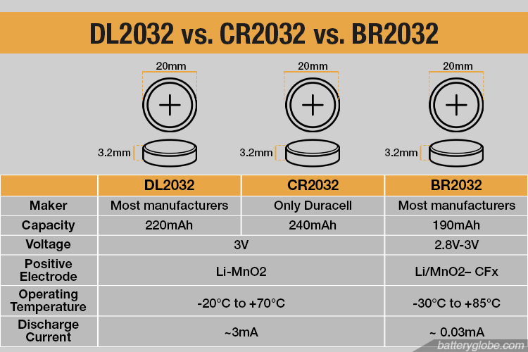

When you have problems with sleep, the fist thing to check is the BR2032 RTC battery voltage. The moment the battery can't power the RTC circuit with the correct voltage anymore your Mac Pro becomes crazy.
Also, if change the RTC battery from BR2032 to a CR2032, you will have to replace it frequently.
Good comparison and some reason why one should use a BR2032 on a Mac:
