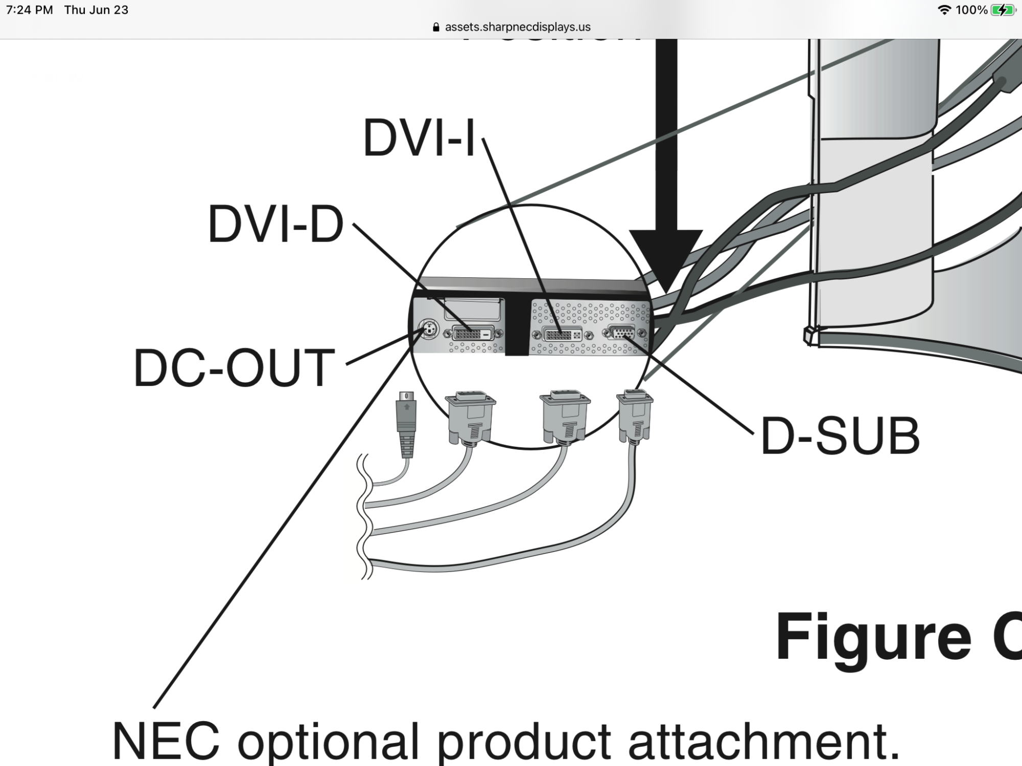

HDMI to DVI cable or adapter is the most straight-forward and less costly as DVI video signal is identical to HDMI.what would be the best way to connect my existing NEC LCD2690WUXi2 26" as a second monitor via DVD-I [1920x1200]?
I’ll be sure to check the configuration of the pins. I did see an adapter on OWC that cost about $14 from newtech. One confusing fact on the description of the adapter was it would only work on monitors up to 24 inches. The NEC that I have is 26 inches. I mostly plan on using this With Photoshop and light room otool pallets, while using the new display for the actual image. Does that change what type of DVI adapter for the size screen that it will work with? Thanks for all your help.HDMI to DVI cable or adapter is the most straight-forward and less costly as DVI video signal is identical to HDMI.

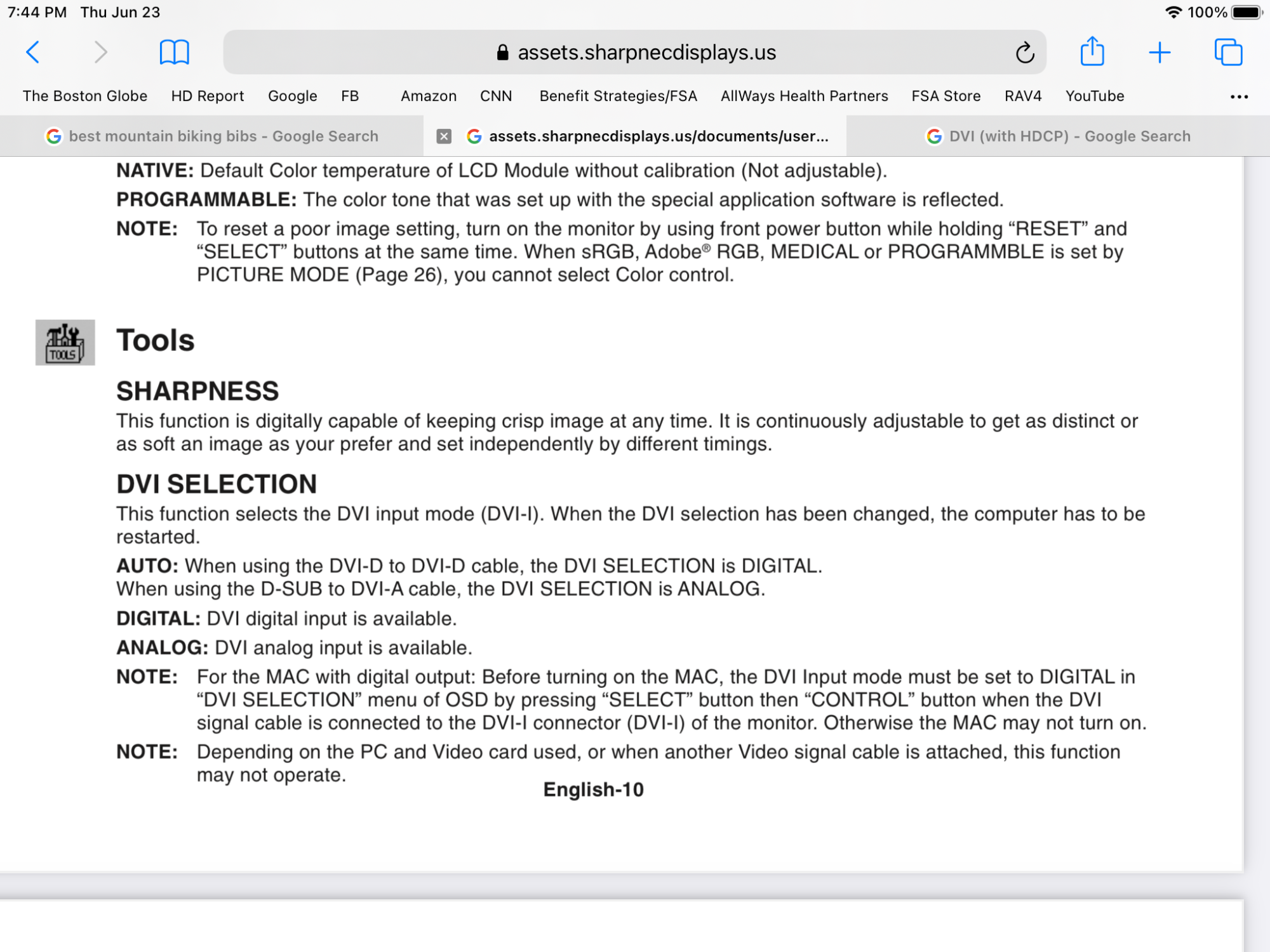

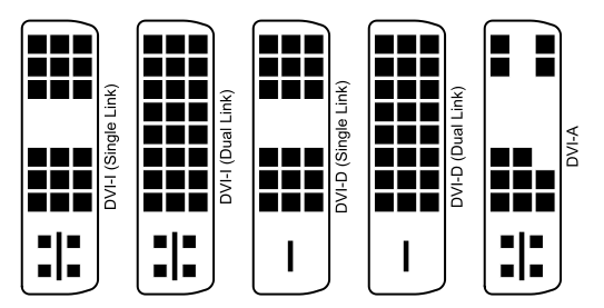

The various DVI types can get confusing. You can google this info, but just make sure if you're re-using your DVI cable, that it's pin compatible with the adapter.
