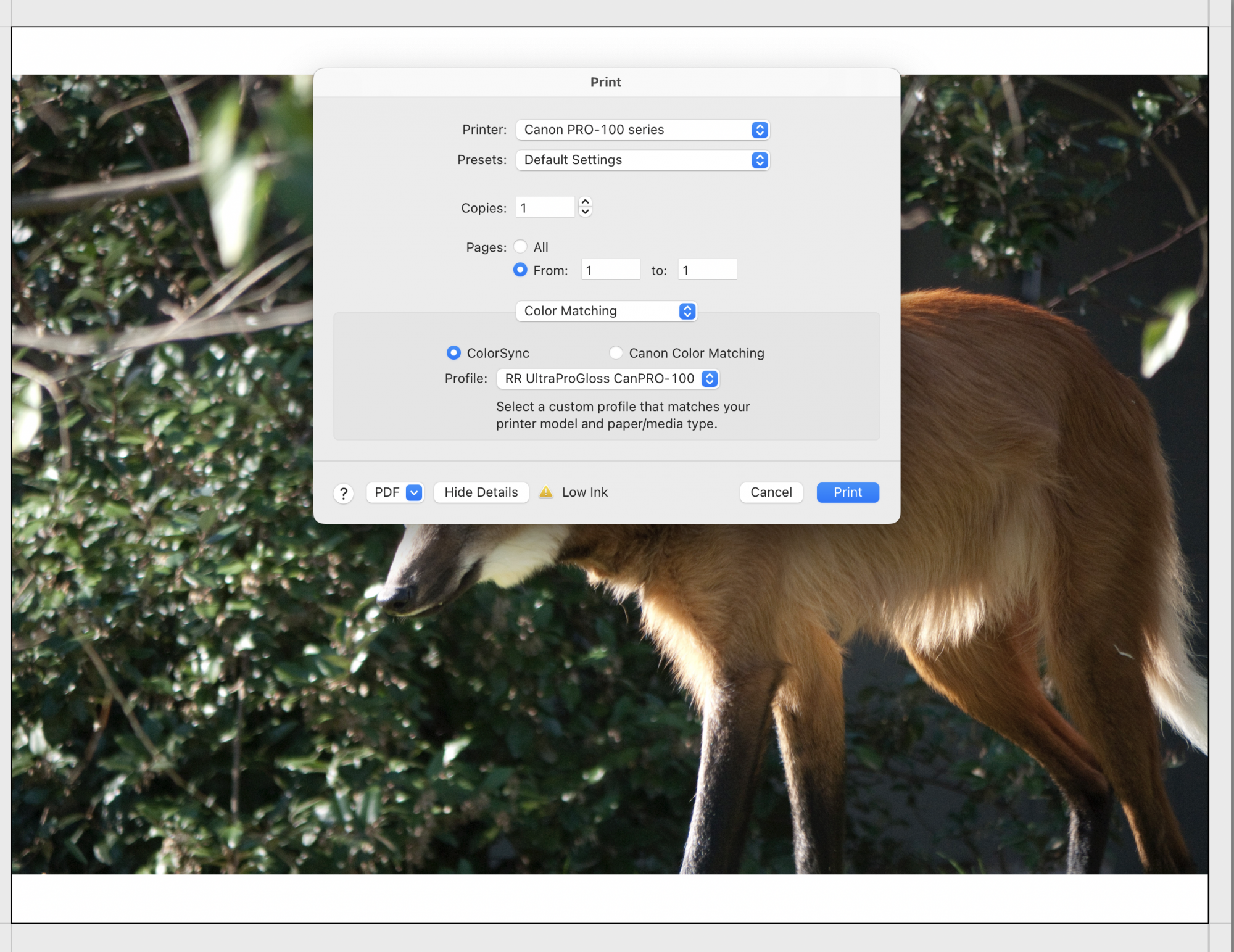

i would check and make sure that it's not using the AirPrint version of the driver. if there's a choice in the printer and scanners system/prefs, select the non-bonjour one!
also, can you show us what LR is displaying in the print dialog?
under color matching, you should be selecting colorsync, then the appropriate RR icc for the 68 lb ultra gloss
find the icc profile here:

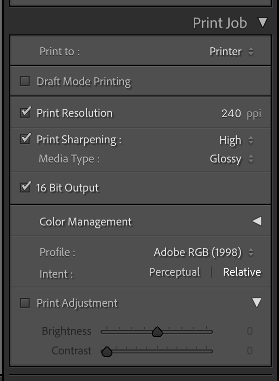

I checked my settings and tried printing with some different profiles (Adobe RGB 1998, sRGB, Studio Display, ProPhoto, and even letting the Printer manage the color. While there is some difference in the different profiles, the result were all subpar.
Your comment about letting the Printer manage the color leads me to believe that you were originally trying to print with a Color Managed Workflow. If so, none of the profiles you said you tried are Printer Profiles and thus not appropriate choices.

So, you’re not using the red river profiles for your printer paper combo? See link in my post.
this is what i see for my ancient version of LR 5.x.
yours should have the RR profile for the ultra gloss/can-TS6300 paper/printer combo instead of my RR UltraProGloss CanPRO-100
My printer is a TS6300. I am hoping the profiles for the TS6320 work I will give this try and thanks for the input
yours should have the RR profile for the ultra gloss/can-TS6300 paper/printer combo instead of my RR UltraProGloss CanPRO-100 View attachment 2007017
I have spent the morning working on this. I am still getting the same result. I Reset my printer (TS6300) and reinstalled it. I downloaded and installed the Red River ICC Profiles and matched my paper to the Media Setting Recommendations. Everything I print on either 60 lb. Pecos River Gloss or 68 lb. Ultra Pro Gloss has a type of filmy look with shadows looking a blotchy purple, faded blue skies, etc... I appreciate your help, but I am at the end of my rope here. What irks me is that the printer works, it prints regular text just fine etc., but since installing the new Studio Mac it will not print color without problems
It is using Air Print and I am now lead to believe that is the culprit. I just saw an article to that effect. I have deleted the printer and reinstalled it, but Bonjour is the only option. I am going to have bite the bullet and look for a printer that does not connect via air print. thanks for your input
