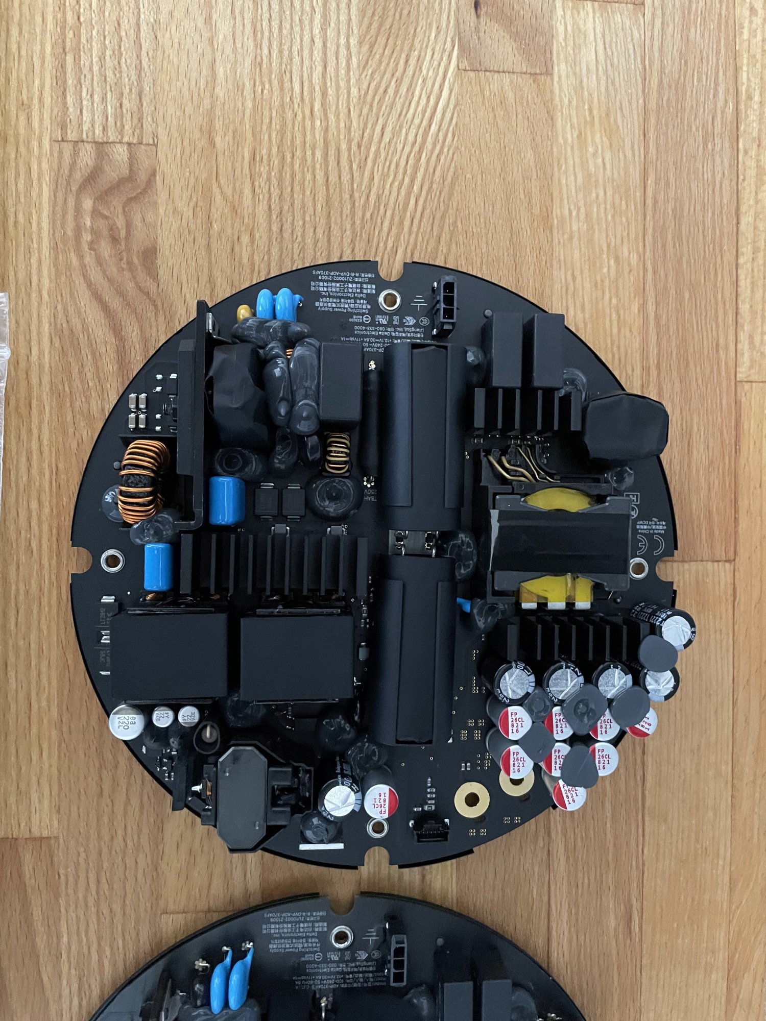

Hello ladies and gentlemens,
unfortunately, i need to replace power supply unit in my Mac Studio. Please do not ask me why (an overturned glass of water has nothing to do with it). Does anybody have an experience with that? Currently used power supply unit is ADP-370AF, but for this one is problem with delivery to my country (Slovakia), i have found, that there is also another one, PA-2371-1A with claimed compatibility with models MJMV3LL/A, MJMW3LL/A, MQH73LL/A, MQH63LL/A, but i have model MJMV3SL/A This one looks to have the same form factor, the same connectors placement and a bit different layout of capacitors. Does anyone please confirm, that this PA-2371-1A could work with my 2022 model MJMV3SL/A?

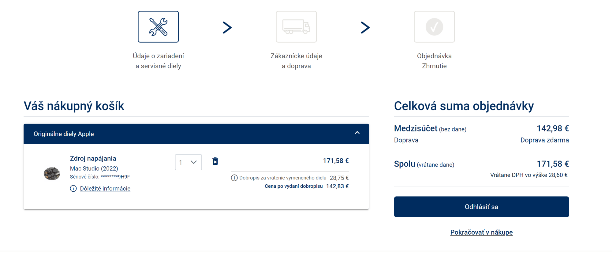

update:
i have found out that selfservicerepair program is available also in Slovakia, and also power supply unit is available for my model (at least compatibility was checked by Serial Number and passed) and according to the layout on the picture of power supply unit is it PA-2371-1A, so..i will see in 7 days :)
