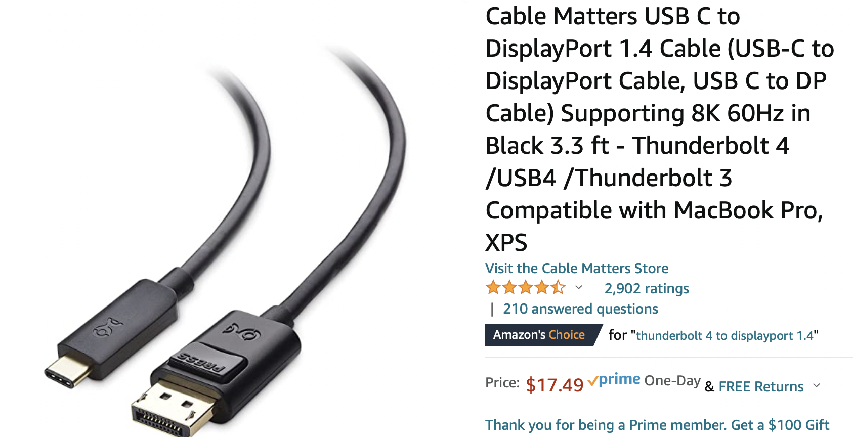

Ok.. just hooked up my mac studio with the G9 using two usb c to display port cables. (No HDMI at all)

Great cables...
I switched now to 1 DP cable and 1 HDMI cable and that seems to work better.
There's some issue with the Mac studio recognizing what's going on when the g9 is in single screen mode with both DP cables connected. As soon as I unplug one of the DP cables it works. And it works fine with 1 DP and 1 HDMI.
