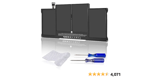

Yes, likely some marginal cells in the battery. When the charge drops below a certain point, then you must get a voltage drop, which would certainly affect the performance. Plug the power adapter in, and then in a few seconds that output voltage returns to a better value, and performance returns with that.
I think your next step is to replace the battery. That battery (same replacement battery for any 2010 to 2017 13-inch MBAir) is mostly easy, and only takes about 15 minutes. There's none of the prying around, and no adhesives to dissolve like you might find in many MacBook Pro battery replacements.
Same battery that I purchased almost a year ago -
(That battery order surprised me with a free keyboard protector!)
Reactions: Datkidwizzi
