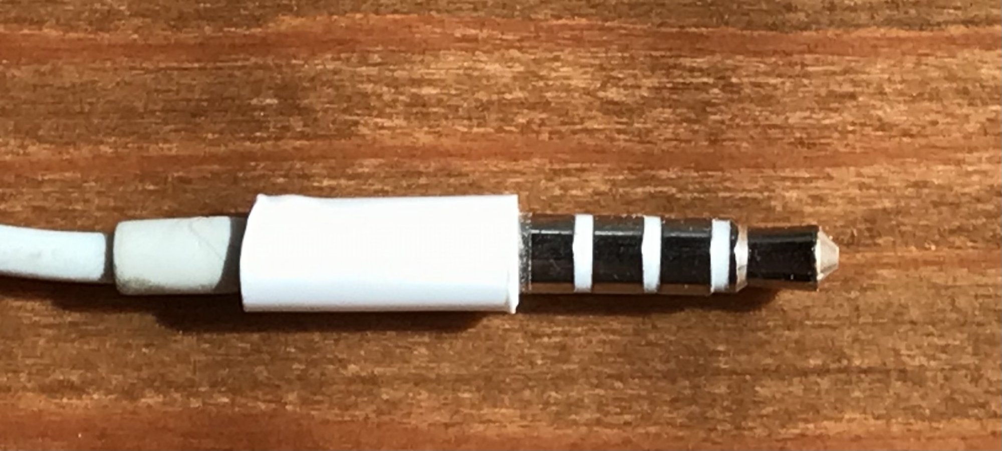

@DeltaMac I will be calibrating the Fozgometer V2 meter itself. From the Musical Surroundings website I will download 3 calibration audio files as example in 1st thread above. I need a cable from the earplug hole (I believe 1/8" dia shaft) that splits to dual RCA stereo jack plugins on the V2 meter. I can then play the sound bites from the laptop to the V2 as I calibrate it. I couldn't find a way to upload a pic of my MacBook computer plugin and which has a ~1/8" dia shaft of ~1/2" length with a slightly smaller dia.pointed tip. Also 3 white dividing bands on the 1/8" shaft.
Once calibrated I will use the V2 to read right & left stereo channel signal leakage from the turntable RCA cables plugged into the RCA jacks of the V2.This is line level output into the V2 from cartridge, un-amplified, weak signal.
Yes a "simple" pair of RCA cables but must be a compatible Apple connector on the RCA Y splitter cable. This I can't find available from Apple-

Bigwaff posted a cable that will be fine for your task, in post #2.
You will see that cable does not have a third band in the 1/8-inch connector. You won't need that, a two-band (plus the tip) gives you left and right right audio output (third is for common/ground. The third band on the one you posted is for a headset, that includes a microphone connection. (That is what the thrid band is used for.) Not necessary to look for "Apple compatibility". 1/8-inch /3.5 mm, to left and right RCA plugs. it's a standard audio accessory... nothing special where Apple made a special version that is "Apple-compatible"

@DeltaMac OK, the Apple 3.5mm connector was what made it impossible to find but as you say I don't need the extra band and will work. Now I see tons of them. But as @DaveEcc says in third post, to be safe, I'll be sure to check volume is hardly on. So thank you all and I'll go with this info-
