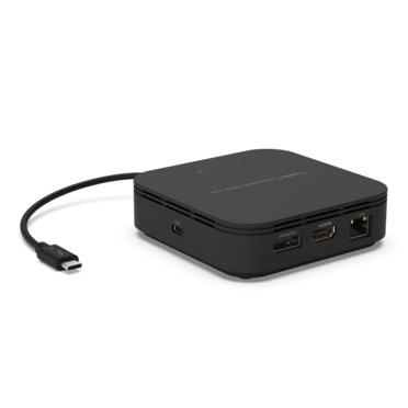

Hi people,
a few days back I bought the Belkin Thunderbolt Dock Core which includes a PD port, I connected it with my stock 30w MacBook Air adapter, but it doesn't charge, in system prefs under adapter options it lists as no adapter is connected. I don't know if it's an issue of the product or if I need to buy a 60w adapter.
I would appreciate your help, thanks.

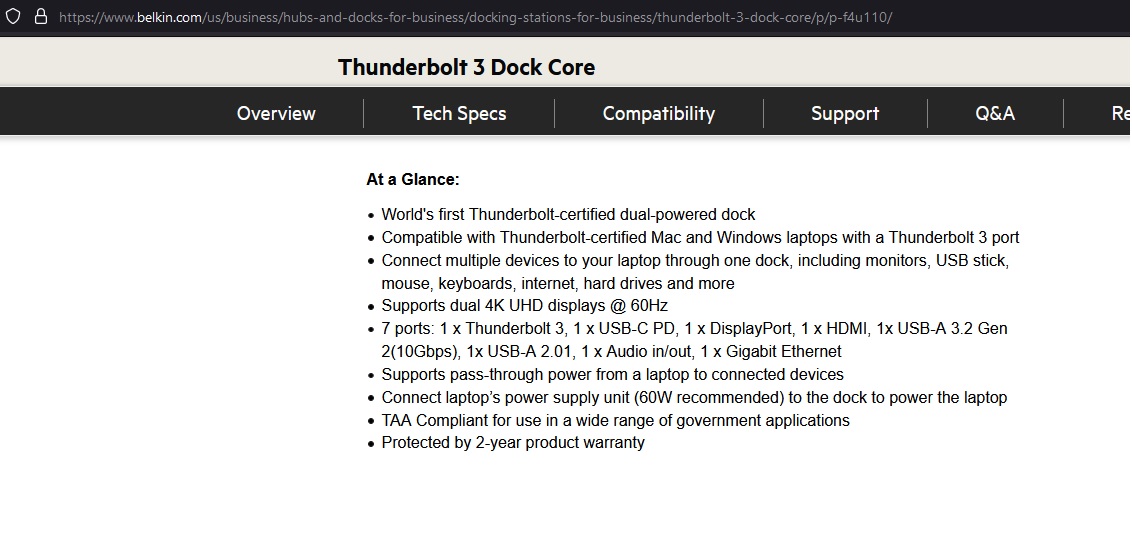

My guess is a bigger power supply should fix it. Even though Belkin only says that 60W is recommended and not required. But i´m guessing it has to do with how many peripherals are connected and many watts the dock itself needs. So try a bigger power supply is my recommendation.

I have two of these docks. They do not accept the 30 watt adapter that comes with the M1 Air. I use a Hyper GaN 65 watt at home, and some old Lenovo 65(?) watt adapter att work.
Of course the Core dock works as intended just powered off of the Air itself.
I understand why Belkin did this, 30 watts is not a lot to charge and power the laptop, and power a dock with any peripherals attached. But they could be more clear on it.
