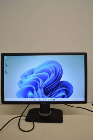

He's running at HD though. I have all kinds of monitors and I'm one of those few people that uses 4k 27 inches at native resolution. In general, I run all of my monitors at native resolution, including HD, WUXGA, 2K, etc. I sometimes run my MacBook Pros at native resolution when I need to. Now, a new HD monitor is probably $100 or less and it solves the problem. He could probably pick one up on Craigslist for $40. That, to me, is a very efficient solution.
I'm not saying to replace the 4k. You can keep it around.
Here's an HD monitor for $40.
Here's one for $30.
One further solution would be to get a 2009 iMac 27 and use it in Target Display Mode. I've seen them for $25. Not terribly power-efficient but it's a very cheap solution in terms of capital outlays.
