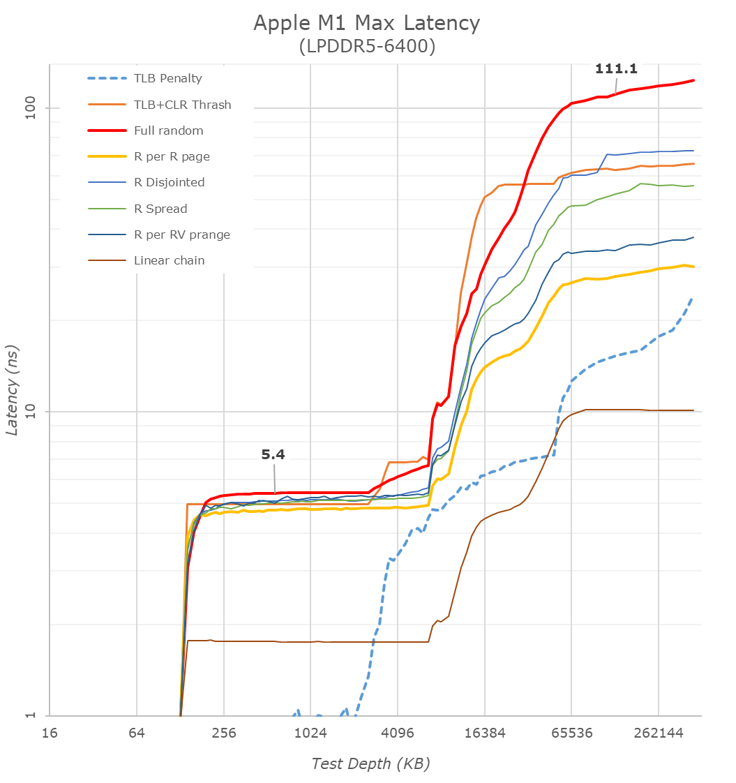

Apologies if this is not the right thread for this, however I didn't want to make a new one - does anyone know the clock speed/CL (cas latency) for the LPDDR5-6400 in these machines? I searched online everywhere for answers but couldn't find anything... I understand they said 400GB/s throughput but I wanted to know the actual memory clock speed. Perhaps you can calculate a theoretical number based on the number of lanes and memory bandwidth?
I don't think they ever release the CAS latency for LPDDR5 but wouldn't be much different from DDR5 I assume.
Memory clock speed is 3200Mhz. Bandwidth comes from 3200 (memory frequency) x 2 (double data rate) x 512 (memory width) / 8 (bits to bytes) = 409,600 MB/s = so 409.6GB/s
Latency have regressed somewhat from the M1 but that is alleviated by the much larger 48MB System Level Cache.
These numbers are from AnandTech, who is pretty much the only source to not just run Geekbench.
I think that Fixit have done their first tear down and they normally mention the exact part number of the RAW modules, so maybe you can google that and figure it out. I would actually be interested to see whether there is any difference between the 32GB and 64GB in the CL numbers, could be a bit worse on the 64GB maybe.
The clock has to be 3200MHz as indicated by various benchmarking utilities.
As for the actual listed CL of the chips it does take a teardown to be kind of sure.

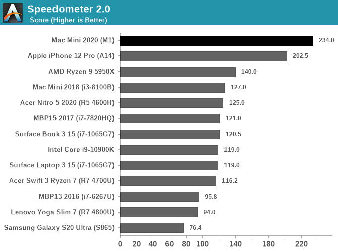

I wish there were more reviews around the 80% typical world usage. Like show me web browsing/javascript performance, macOS performance on launching apps, MS Office, etc.
I feel like Apple and every reviewer who is a content producer thinks we are all video editors when that probably makes up like 2% of mbp users.
An M1 works just as well for such non-heavily-multithreaded light-weight tasks...
Typical computer users don't need the M1 Pro or Max.
The M1 is more than fast enough for those workloads you mentioned and so are computers sold the last 10 years.
With that said I believe you will find M1, M1 Pro and M1 Max to typically be the fastest in javascript and web browsing experience as Apple have prioritised that in their processor design.
Just find some tests of WebPXRT, Speedometer, JetStream, Octane, Kraken and SunSpider.

Thank you, that makes sense. Do you think 3200Mhz is the base clock or max clock under load?
That chart is exactly what I was looking for, thank you. I'm not too knowledgable on the inner workings of RAM (I'm not sure if you would even call it RAM), what do you mean by saying it is "alleviated" by the much larger 48MB System Level Cache? I was able to find the article where that image comes from, and one of the things he says (in reference to the 48MB System Cache) is : "While being much larger, it’s also evidently slower than the M1 SLC – the exact figures here depend on access pattern, but even the linear chain access shows that data has to travel a longer distance than the M1 and corresponding A-chips". I'm confused now, what effect does the System Cache have on memory latency?
That’s the base clock which is also the max clock. RAM does not support opportunistic overclouding like modern CPUs do. Although, if I understand it correctly, RAM can be throttled to reduce power usage in scenarios where you don’t need full performance.
Historically accessing RAM was really slow and caching were invented to store the most needed data ahead of time. That way you could try and prefetch what data was needed next by the processor and speeding up the execution time significantly.
Increasing these caches give you a better "hit" rate as you can store a broader range of prefetched data and if successful spare an "expensive" trip back and forth from main memory to locate the data.
LPDDR5 memory clock is 400Mhz, 3200Mhz is the memory bus clock
Yeah, I know. Just far easier to go by IO clock when calculating bandwidth. You also gotta know the prepatch size with Memory clock while you can just simply double the IO clock when calculating date transfer rate on DDR ram. I think when they refer to memory frequency, they just go by the IO bus clock frequency pretty much all the time.

In case you hadn't noticed, what I was responding to was mostly about benchmarks for web browsing and office applications.
