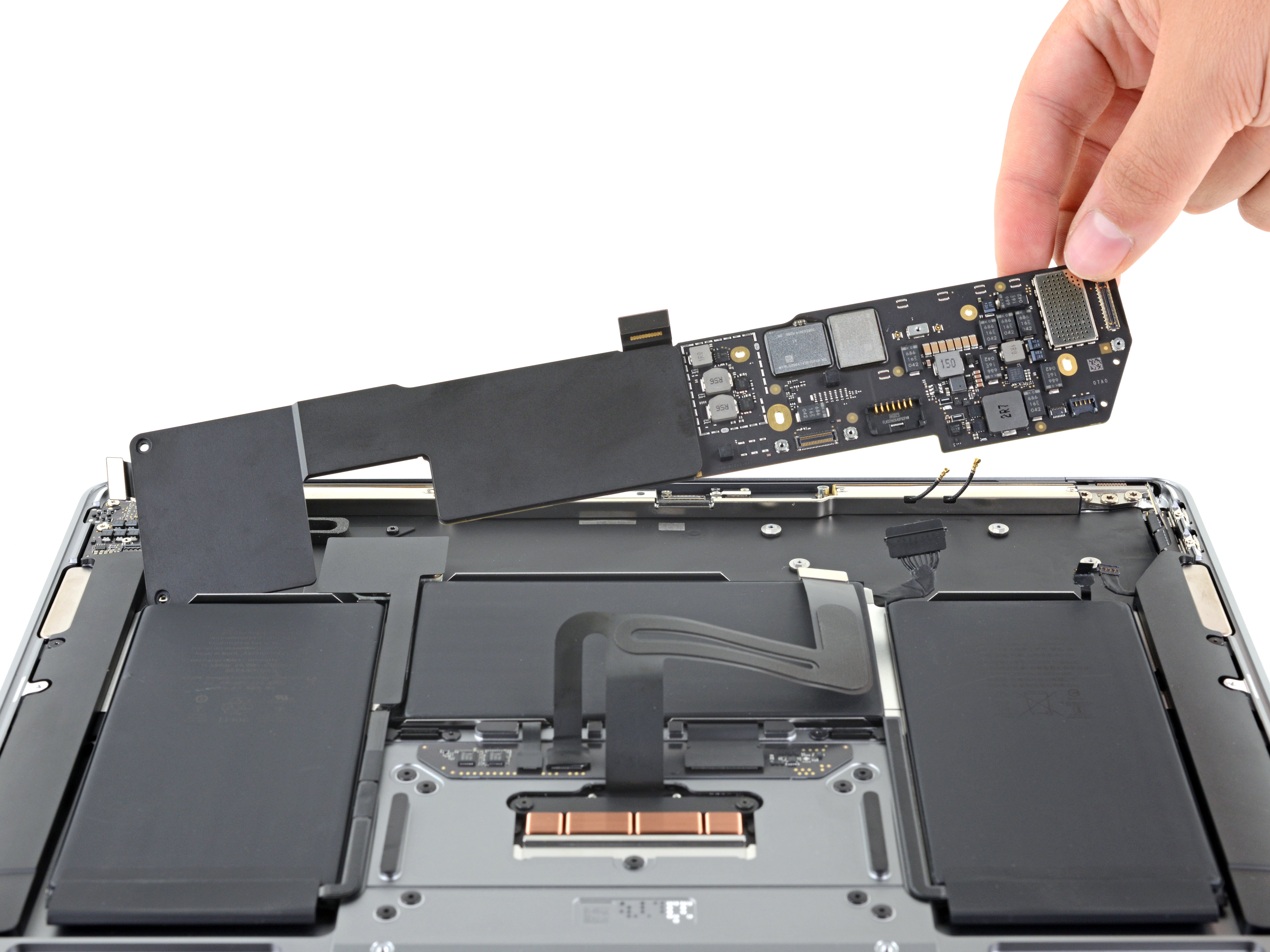

Backup your data immediately. Sounds like a new motherboard is in your future.
Probably better off selling now while it is working as parts/need repair and buying used MBA M1/2. These are so cheap on used market.

Thanks for the reply. This is of course the worst case scenario, but I am also inclined to think that the motherboard is broken due to hardware. I will try to contact a local service center, maybe they can replace the broken component inexpensively without changing the board completely. If it works out, I will write here. Otherwise will likely look for a new device.
