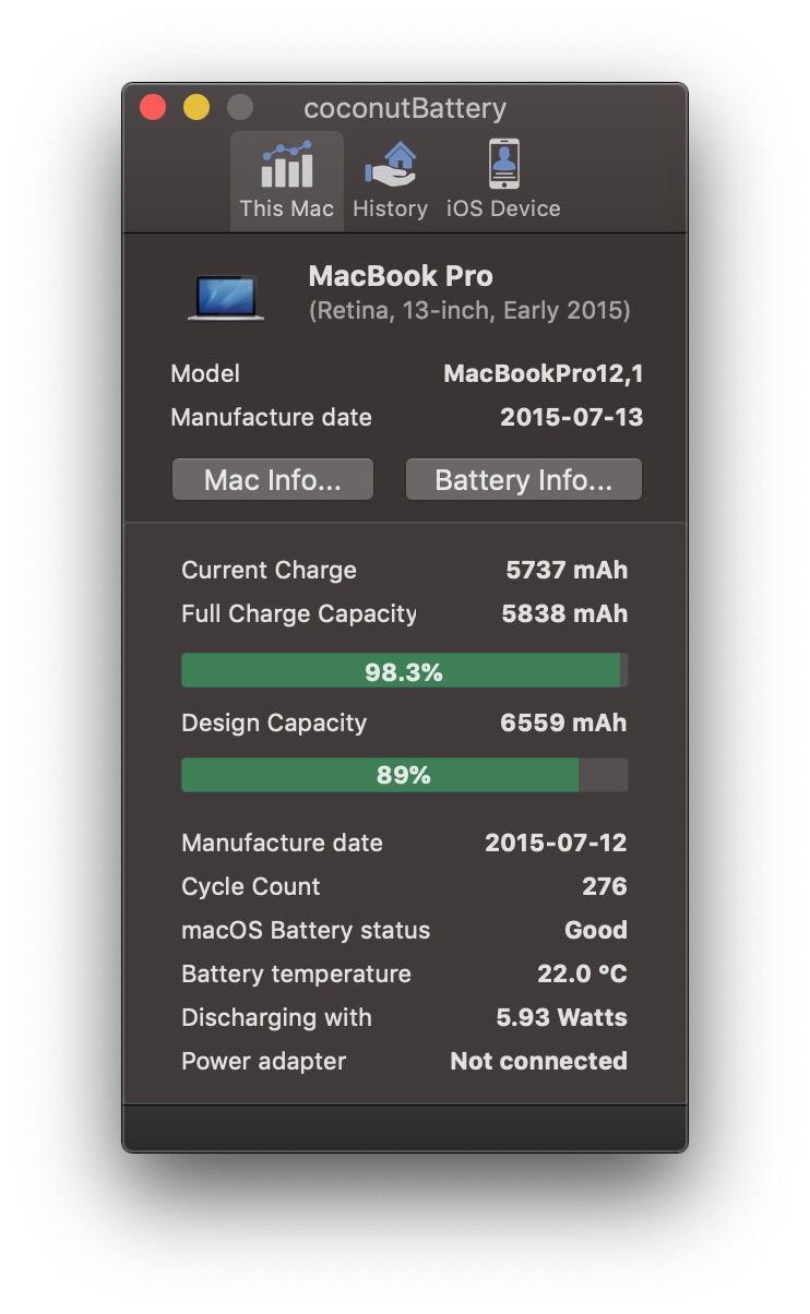

I've downloaded Coconut Battery and did the check as per screenshot below. All appears 'Good'. Perhaps just a gremlin in the system? Is it worth doing an NVRAM reset? I've never done that.
