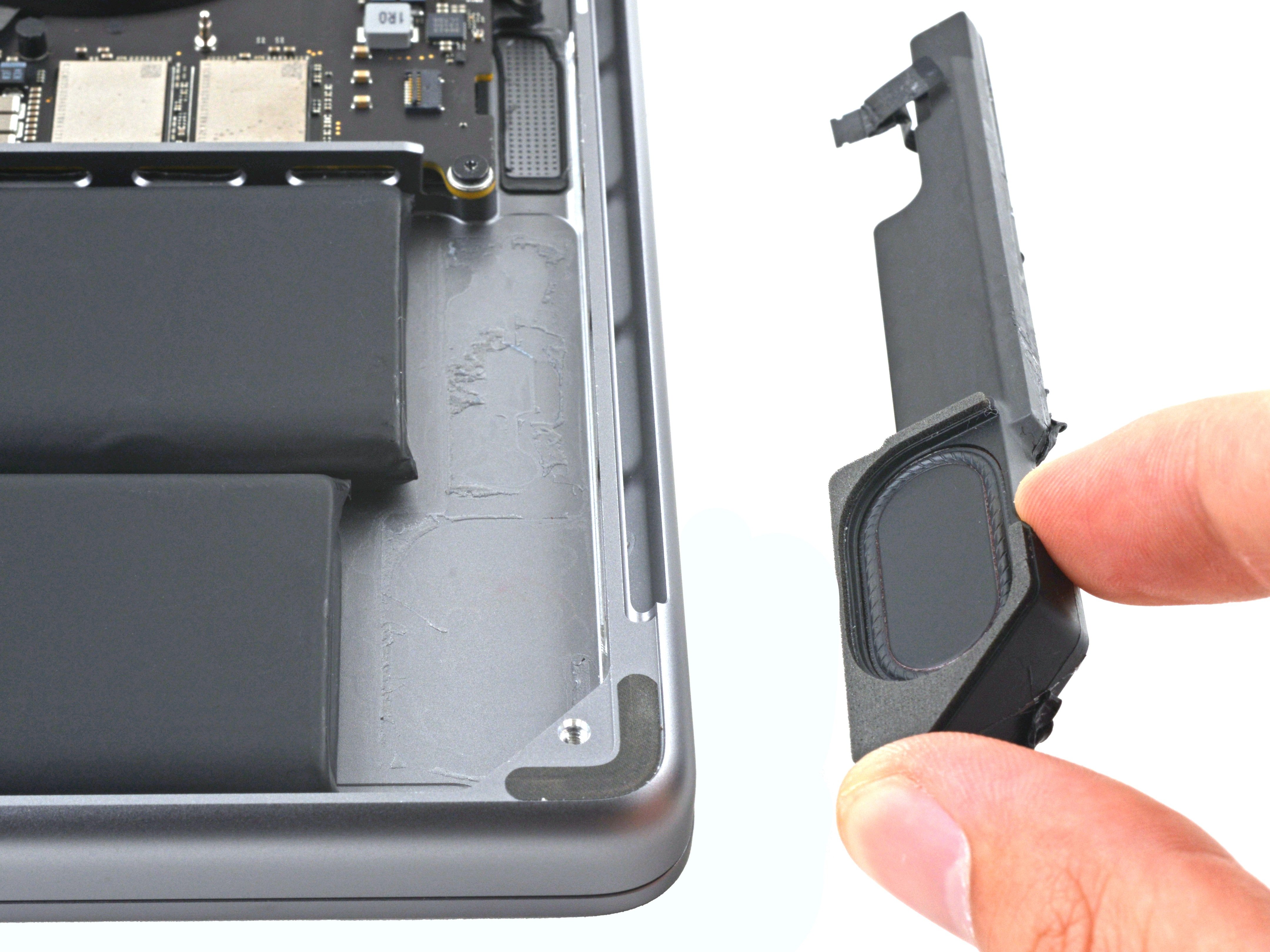

There are 6 speakers, I suspect one of the woofers on one side is faulty.
This may be of interest (not suggesting you do this yourself; also, this is unlikely to be the approved official repair procedure):

Under normal circumstance I'm not one to shy away from doing my own repairs, however, if apple will cover this for free might as well take advantage of that while Im still under warranty. Thanks for all the help and advice!
