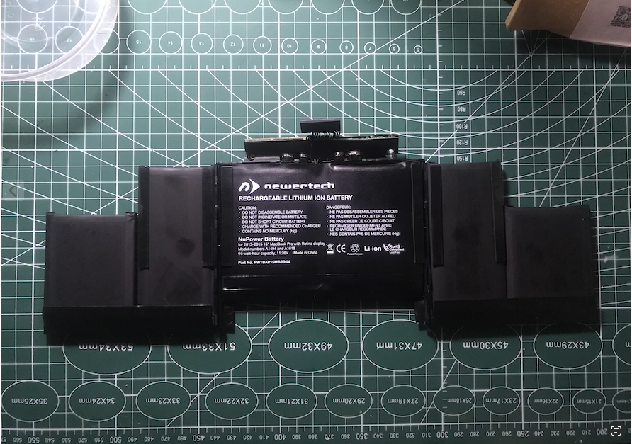

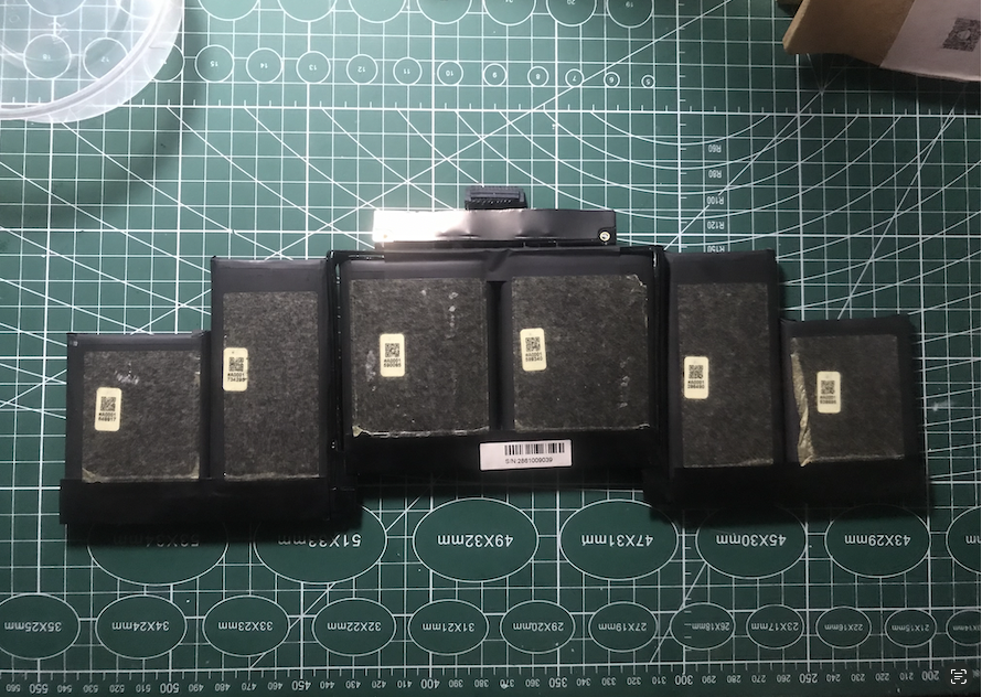

Just a few hours ago, the battery arrived. I proceeded to open the underlid of the laptop, disconnected the battery from the receptacle, removed the screws, had the cord ready, then started what I though was going to be a long, tedious activity.
I started inserting the cord around the first cell to the left, but I noticed it wiggle as I was examining it. I propped it up with a finger and saw that it was already loose. I checked the other side cells, and they were all loose and easily popped out.
I checked the middle cells, they were still firmly in position, but with a little more forceful prodding with my index fingers it came loose quite easily. I was able to lift the entire battery without even breaking a sweat in under 5 minutes.
How?
The Newertech's adhesive was too weak and didn't engage on the metal surface. When I flipped the battery, it was basically intact. Only the leftmost cell (rightmost when flipped) showed a little damage. I proceeded to clean some residue, which I suspect was from the original battery, with 99% electronic grade IPA.
The battery isn't even that bloated unlike the original one previously when I can barely close the lid because of how deformed the trackpad area was.
