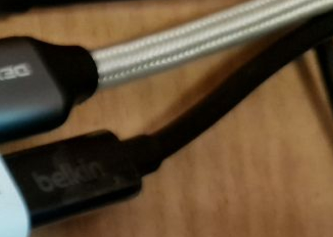

Things I tried:
- PRAM/NVRAM reset (command + option + P + R)
- three different cables - one I use with my other 4k usb-c monitor, that came with it (LG 27UL850), two 4k@60Hz 10Gbps, c-c cables with 100W PD capabilities
- tried two different Macs - MacBook Pro 16 and MacBook Air M1 - on the M1 it doesn't even show up for 10s
- IN SAFE MODE IT WORKS - but just up to 1920x1080p
- USB-C to HDMI adapter works fine, but its just 30Hz at 4K
I don't want to use any other connection but USB-C.
