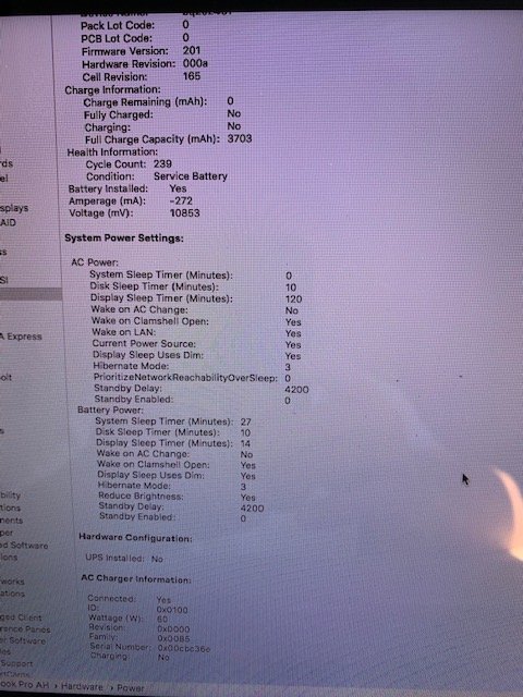

I have also attached pic of the battery info in Apple System info.
