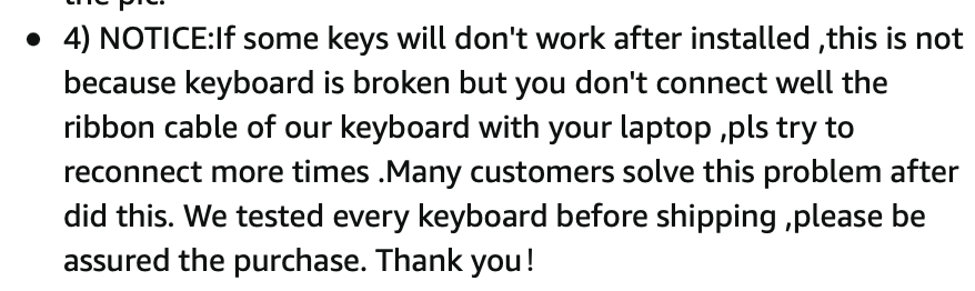

Most vendors include this message in their listings. Worth the try.
Use a magnifying glass to check if the end of the ribbon cable is not bended
in the sides. Also double check that it's fully inserted. Third-party keyboards
use a thicker ribbon cable that can need more insertion force in the connector.
Be careful! The connector is very fragile!
