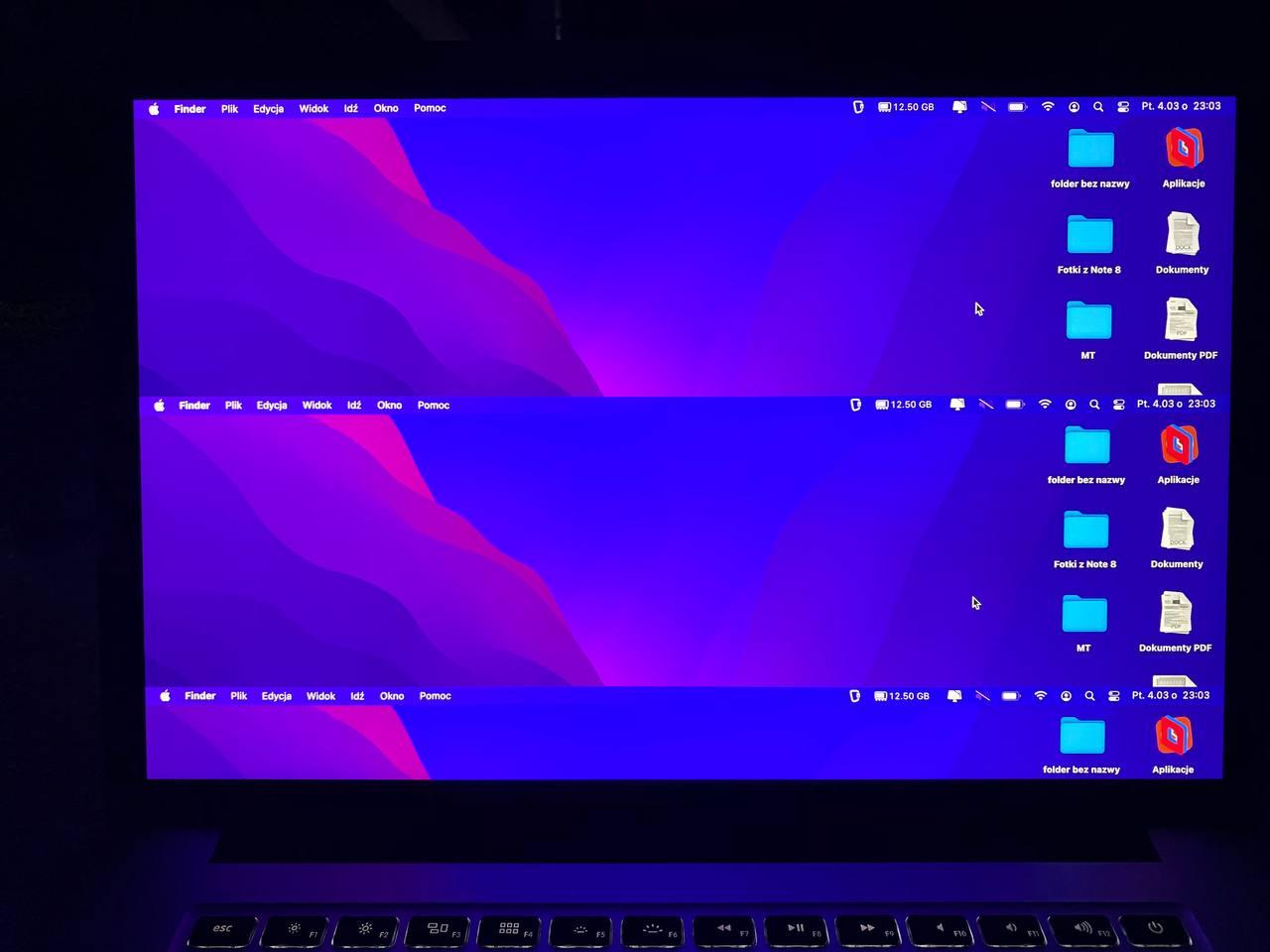

Recently my retina display started flickering. It happening randomly, seems like the display is not synchronizing. Usually after 2 minutes after the startup. This issue is only present on the Retina display, when I use external monitor, everything is fine.
I want to point out that I didn't drop or hit the MacBook, this suddenly happened when I was web browsing.
I did already try first to unplug LVDS cable and plug it back, but it didn't work. So I decided to replace LVDS cable but it also didn't work.

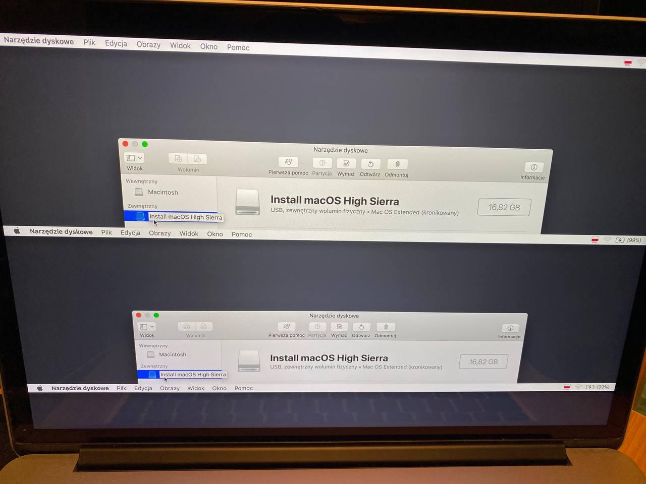

I did upgrade to Monterey and then downgraded to High Sierra, the issue is still present. Since there is no physical damage to hardware, I would say it is something wrong with power management/drivers?
I read somewhere that the dust could cause this after some years, but I cleaned it and the LVDS cable stick to the connector just like factory made.
What else could I check?
