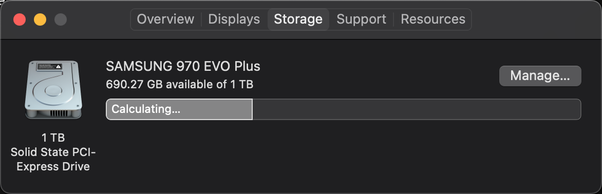

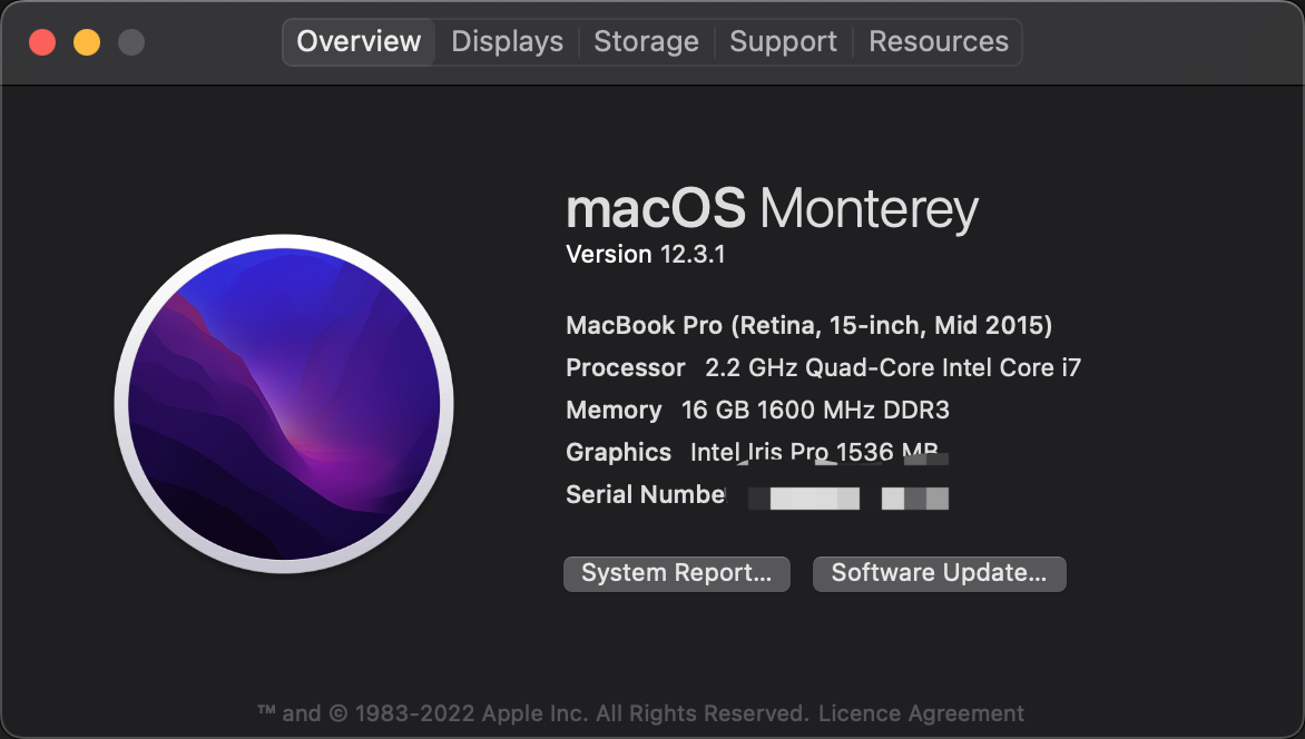

Hi dear,
Recently, I have noticed that Mac OS released the 12.4 version. I am trying to upgrade it from 12.3.1 to 12.4. before the restart, everything looked look going well, but it was still on 12.3.1, and nothing changed after the restart.
Maybe the problem is because I have upgraded the SSD to Samsung 970 Evo Plus with a not recommended SSD adapter.
So is there anyone who has to meet the same with this problem?

Click on About This Mac, and select System Report.
Under Hardware Overview screen, look at the "System Firmware Version".
What is listed there?
The latest should be 476.0.0.0
If your's is a lower number, you still don't have the latest firmware upgraded.
thanks, mate, I have already checked is
System Firmware Version: 476.0.0.0.0
